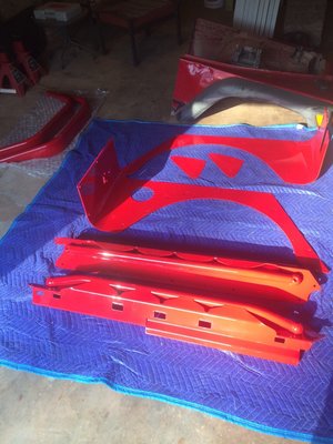

Picked up the sliders today and while I was there, the windshield armor was finally in the paint booth.

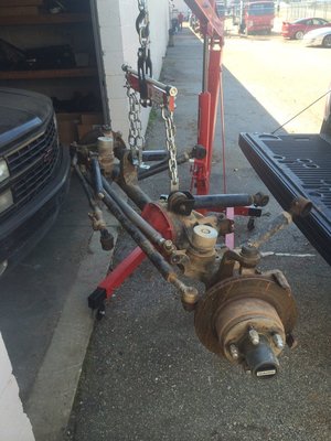

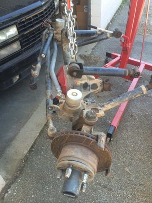

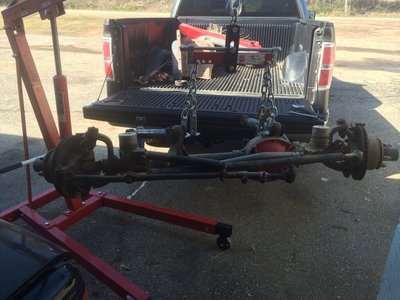

Turns out the spindles that I had with my axle are no good. When the bearings were installed instead of seating properly, they just spun. So, new spindles added to the build.
