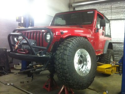

In the picture from the front looks like you can cut the axle side mount down and will give you some more room between track bar and frame...I'd also throw your drag link on to make sure your angles on track bar and drag link are the same looks to me like axle side can come down a bunch

That's the plan, just waiting for the knuckles to get done at durham's shop (getting the flat tops machined for the high steer arms). And the everything will be together so we can see. Then we will know what path to take. He will most likely notch the frame and may also go ahead and do an engine lift.

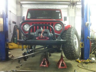

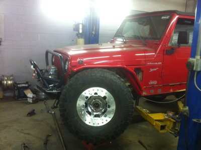

Stopped in to drop off a few more parts (air bumps and brackets). Looks like I may not be able to do the high steer setup with the amount of lift that I have. Too many things trying to occupy the same space. But Cole is going to try a few more things to be sure. I may have to run the tie rod in the normal location but may still be able to run the track bar to the high steer arm. It's the track bar and the tie rod that are interfering. Should have it all figured out today and welded up. I left the front fenders for him to mock up so he can test the flex so he can set the bumps right (keep the tires out of the fenders).

A couple pics from today.
The knuckles are back machined and drilled for the high steer.
And just another picture of it being worked on.
