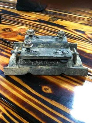

Mine was doing this and it was the tranny mount. It's hard to see up in there but the rubber part of mine was totally in two pieces.
#97
Trams mount was ok but one bolt was spinning on the backside. I had to cut it off,so I guess I'll have to replace it anyway.
Don't know what your future plans are regarding a tummy tuck, but you could throw a little extra coin in and get a lopro tranny mount from Undercover fab. It is a must have if you plan on having a completely flat skid if you don't want to make a separate cross member.
