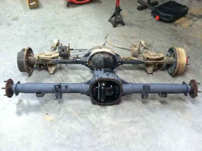

This might be a stupid question, but is it ok for the drive shaft flange to be off center on the 8.8? This might be a more stupid question but do I have the axle right side up on the photo?
Yeah its fine, and you have the axle right side up. Tons of people run them with no issues.. Did you get some brackets for it yet?
#59
The abs sensor and fill plug are in the top so it looks like you've got it the right way. The pinion is offset slightly but that shouldn't be an issue.
