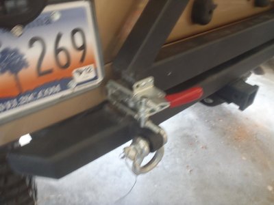

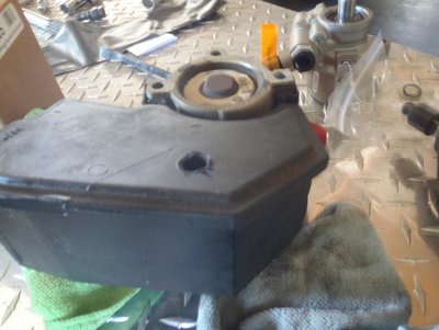

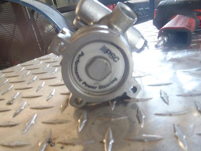

Didn't like the latch on the Smittybuilt tire carrier so with a little cutting and welding I replaced it. Now it doesn't rattle. I also ordered a PSC power steering pump.
Broke the fitting off the plastic resivor, should of ordered the aluminium one.

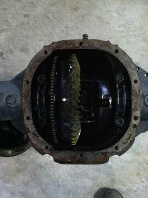

Broke another shaft. Picked up this 8.8 last night. It's a factory limited slip with 456 gears profesionally installed, it's been sandblasted and primed and never run. Thanks to Larry for turning me on to it. ImageUploadedByTapatalk1355688766.833302.jpg
