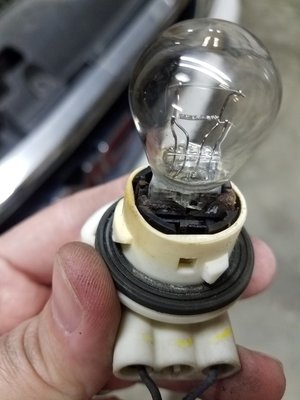

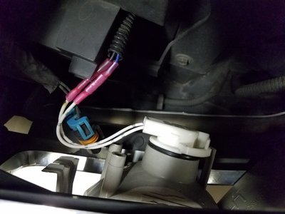

One thing that drives me crazy in the 99-06 GMs is the popeye daytime running lights. A couple years ago one of them went out. I pulled it apart and found the socket to be brittle and the bulb basically welded into the socket. I ordered replacement sockets, but when I put it back together "temporarily" they worked so I never changed them. This morning I noticed it was out again.
These DRLs run all the time, get hot, and the sockets can't take it. You can buy the sockets with pigtails (and the tail lights and a other sockets are the same).
GM hit the pinnacle of design with the ease of headlight removal in this generation trucks, then they went down hill bigtime...

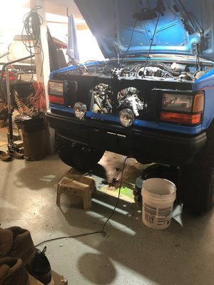

Finished mounting my “new” tires, did a bolt check on my steering because it was beginning to wander (found the culprit), adjusted my steering limit to keep from loosing the tread lugs on the inside of the driver tire like in the past. Todo list: fix the pimp lean, install exhaust, install heat shielding for the fuel system.
WolfGT
is the pimp lean a Coilover setting? or do you need a spacer for one of the rear coils? Whats causing the lean?
I’m not sure. After I put the rear springs on, it showed up. I adjusted the front coils a little to compensate and it helped but as everything settled, it has gotten worse. Very noticeable now. So bad that the front left front is setting on the air bump.
I can't recall which springs you installed, but my OME coils were labeled Driver/Passenger to account for the torque twist of a Jeep. Is it possible you have them backwards?
WolfGT
I know I didn't put them in by any type of driver/passenger labeling, maybe I missed it. I will get under there tonight and check. I can't even remember what brand they are, I know I had to try a couple different ones. The first ones didn't work out because of the extra weight in the back (armor and toolbox). I ended up getting an HD version of something, just can't remember what.
