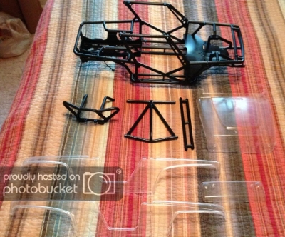

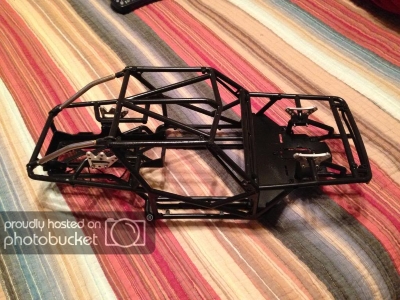

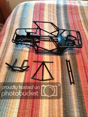

Well I had the day off work and the truck is in the body shop so I stayed at the house and worked on the wraith. Took it back apart and cleaned up the cuts I made with the lexan scissors and trimmed alittle more and wow it looks so much better! I also gave the chassis a few fresh costs of black. image-6.jpg image-5.jpg
the body panels look good. If you have any places that are rough and you cant get them with the scissors, you can use a sanding drum on a dremel tool to smooth them out. I can't see any spots in the pics, but just saying. Hell I cant see **** right now period.

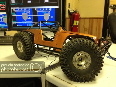

Well ill be the first to admit that its no any where near a perfect job done with the body, but its finally done! This was the first one i had ever done and it took alot more time than i thought it would! I got to the point where i knew there were mistakes but i really just didnt care and wanted to be done with it, learned alot for sure and will be much more prepared if i ever do another one. Well here it is.

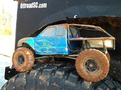

Wheeled mine at lake hartwell and broke some drive shaft set screws and broke the front output on the transfer case so now I gotta order some parts

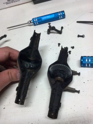

Tore the front axle down today, Just to do some PM, Looks like ill be building a completely new one. Just about all the stock Axial bearings are TRASH... Locker Cracked, Pinion wore out, axle shaft u joint wore out...
Cleaned everything up in my Ultrasonic cleaner, Really did the trick.
Here is the pinion gear, Notice how sharp its getting. 201303mmm.jpg Cracked locker, due to not enough shaft engagement. 201303qcq.jpg
