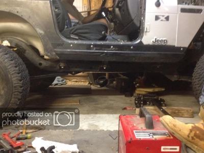

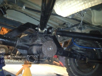

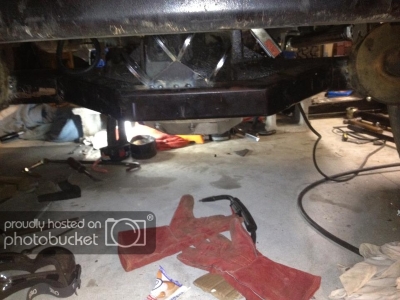

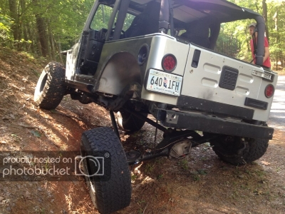

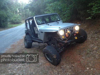

finished up my shock mounts today, and bled my brakes. this thing is a whole new jeep. it drives better in front wheel drive than it used to in rear wheel drive! it is so stable on the road is not even funny. i love driving this jeep now.

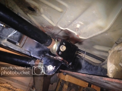

i do have some stuff i need to address soon, first off being there is a leak from my transfer case. i think its coming off the speedo gear, so hopefully the o ring just didn't seat properly and didn't seal it off. if its that, that will be alot easier than pulling the case off... but i will need to pull the sye off soon, because me and my retarded self put the speedo gear that goes on the shaft on backwards. so my speedo tells me how fast i go in reverse, but does nothing going forward. so that will be addressed at a later date, dont feel like jackin with it right now, i'd rather be wheelin.

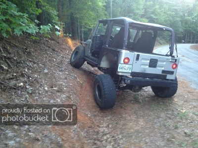

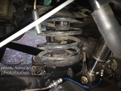

another issue is my links hit the frame before my bump stop hits the bottom of the spring perch. so i need to get bump stops and limiting straps soon.
other than those few issues, im overly impressed with how it came out. it tracks straight, no weird noises, no trans banging into the tub from the flat skid.
all i got left to work on now is getting my xj shaft shortened, pluggin up my arb compressor and find a place to mount my shock reservoirs cause right now they are zip tied

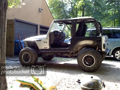

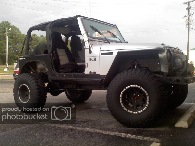

here are some pictures
shows the need for some bumpstops. its better than my shocks bein bottomed out though!
