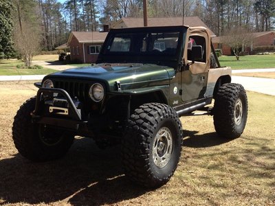

Worked on the Jeep all day today. Aside from a little welding on the trackbar bracket, she is ready to roll. ImageUploadedByTapatalk1396208847.615188.jpg

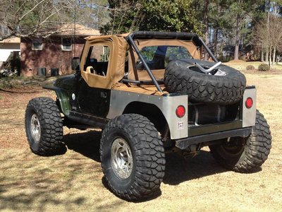

She is running great right now. I have a makeshift aluminum tailgate going on this week too.
Looking good as alway Nick. You should look up that guy on here that has the old Renegade stickers on his green TJ and see if he would mind you copying his idea.........comawwwn!

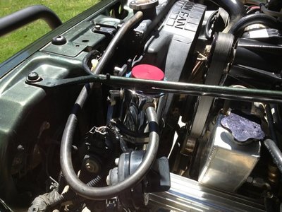

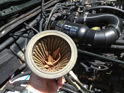

Maybe it's time to do away with the cowl intake. No wonder it didn't idle crawl as good late in the trip.

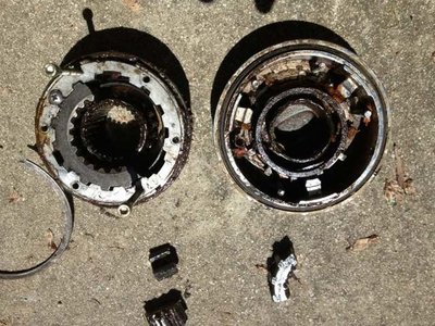

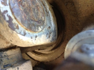

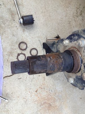

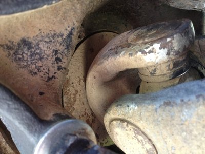

Looks like I broke a hub too.

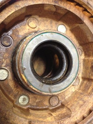

These are good seals here.

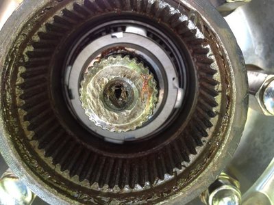

These slinger things are trash. I believe they are the stock style right?

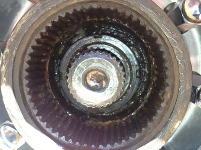

The hub on that side was slam full of mud, rocks, rust and water. The broken hub was on the side where I forgot to install the axle snap ring at Windrock. Forgot all about it.

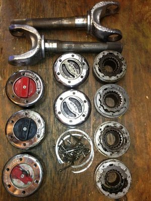

Anybody need any of this 30 spline 60 stuff? I have another set of stubs too. Gonna be listing it all soon.
I don't believe that slinger is responsible for all this mud intrusion but certainly the water. It's either that or the hub seal. If it was the slinger than the mud would have had to travel through the inside of the spindle around the shaft.
I guess it's a little bit of both.

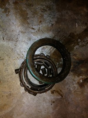

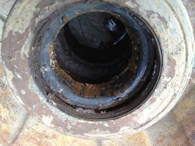

I cleaned it up and realized the bearings were totally wasted.
These were all new everything when I built the axle. I replaced the slinger on the driver side at Windrock with a v notch seal and that hub is spotless inside. I don't know but either way everything is getting replaced.

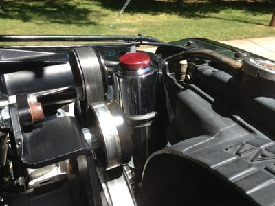

Installed a new radiator overflow. My borrowed CJ one didn't hold up to the Harlan punishment.

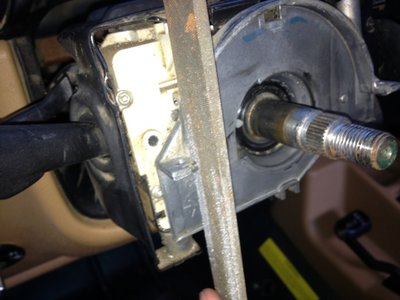

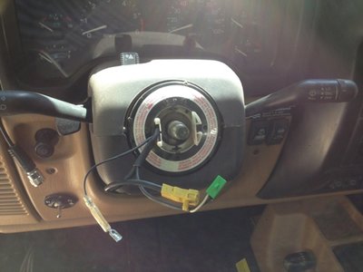

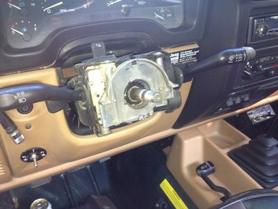

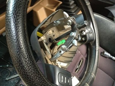

Removed my steering wheel.
And the clock spring.

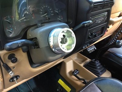

Had to grind a bit here for the Grant GM#5196 adapter.

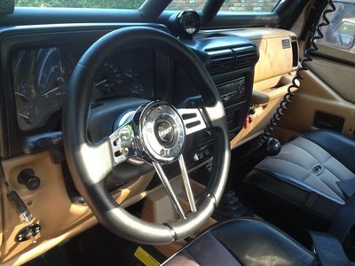

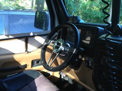

Installed this wheel that I absolutely hate. Already ordered another one.
It's not the look that I did not like, the wheel is just very cheaply made and too small at 13.5" It also has a terrible feeling foam grip. It's garbage. I also can't get my finger between it and the wiper switch. Got a 14.5 coming with hopefully a better grip.
