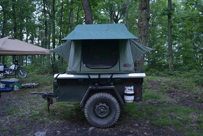

Ordered my rtt last week, and it should be here next week. I also have the lid installed, and mostly painted aside from the top which I am waiting for the rtt for that...got the new TreadWright 215/85R16 mud terrains installed today...pics to follow;)

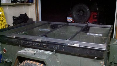

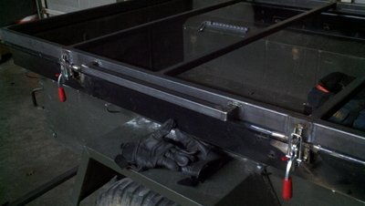

Why did you sell your alum one to build a steel lid?
The last lid was just skinned with aluminum. The frame of it was steel. I'm building this one out of thinner steel and thinner steel sheet metal in hopes to make it similar weight but I can do it myself instead of paying somebody to work the aluminum.

I bought a sheet of 16 gauge steel to skin it with, but I am debating using aluminum again. It would literally weigh half as much.
16 gauge steel weighs 2.5 lb /ft^2 so the total lid would be 60 lbs in skin alone
12 gauge aluminum is what I used on the other lid and it weighs 1.14 lb/ft^2 so the lid skin would weigh 27.5 lbs
but now I'm at the point where I have the steel here and I dont know what to do with it if I dont use it...
I'm waiting on a call back on the price of a 5x10 sheet of aluminum.
