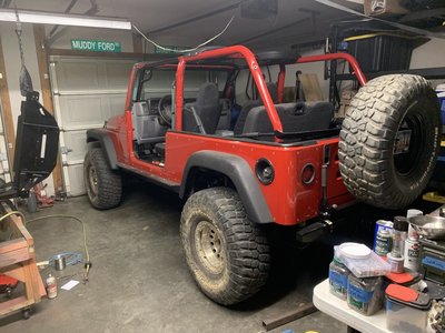

I know this is worthless without pics but got the rear bumper all painted over the last few days and installed. Also took the winch off the plate and sanded and primed the winch mount plate tonight. Too dark in the garage for bumper pics as it’s by the door in a corner right now
Also, I'm trying to decide how I want to mount my tag... I didnt want to put it back on the body, but I might. Thinking about on the rear bumper above the hitch so I could easily add a tag light, or in the spare tire?
How do you guys have yours mounted?
What exhaust shop did you use? I made bracket in tire carrier for license plate for easy removal.
I dropped it off at Mikes Garage here in Chapin. I saw some others that had good work from them. and its a mile from my house so I could easily drive the jeep over with straight headers.
I was just thinking as I thought about the mount, I can't put mine in the tire, because the trasharoo will block it when I'm on trips.
Got the exhaust run, its not how I would have done it but I think it will work, He actually googled longarm exhaust setups for jeeps and ran it under my upper, but he had to account for full droop in the rear, so it hangs down about even with the bottom of the frame to go under the upper. Either way, I think it will be fine, but it may see a rock one day. The sound is much better with the 2.5" tubing, i had 2" before I think.
Just came down to the kitchen and the garage smells pretty strong of gas. I filled up the tank yesterday after the exhaust shop. I don’t see any obvious leaks. Maybe an evap line?
What all did you remove from your fuel system?
nothing, everything is still there, I may have missed a vacuum line somewhere. Let it run outside today for a few minutes and pulled it back in. I can't tell where the smell comes from, its not strong enough until i park it in the garage. All of the evap system is still there.
