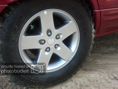

well it depends on where its rubbing...from what i see i dont beleive wheel spacers are the anwser..it looks like the tires going to rub the bottom of front bumper which should be trimmed..are the tires rubbing on the inside?? if so what?

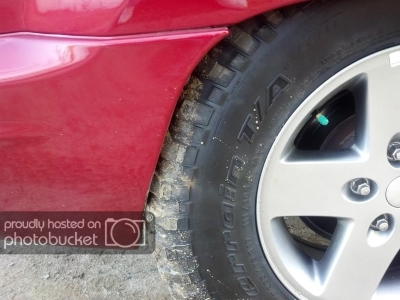

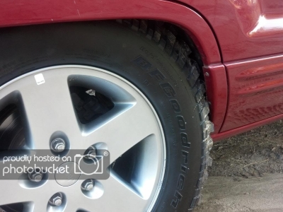

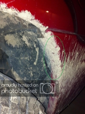

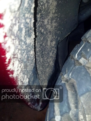

Tried to take some pics of the places that rub, sorry for all the dirt this is from the test run which revealed problem spots, didn't have change to wash it since:
Rear wheel is reaching outer side of fender (green oval is showing the spot), probably only think that can help is bump stops, or smaller wheels:
Front wheel is reaching the fender and inner fender during turns, but seems to be fine on bumps:
I'm thinking on trimming the fender, but I will need to do it so accurately that it is invisible, or else my wife gone kill me, need suggestions on tools to use to make smooth cut, she just do not understand all this offroading yet. I'm new to it, and haven't convinced her yet that it is good recreation, but this is just question of time, and I want to wheel now, dam.:grinpimp:

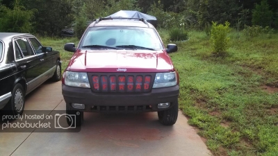

Finally some movement from dead stop. I already solved problem with front bumper, now only concern is rear. I'm currently thinking about installing bump stops as immediate measure for rear, but I’m wondering if I can upgrade my coil springs to something longer than stock and add another 1-1.5 inches of lift. Have anyone tried anything like 3-3.5 inches of total lift without changing shocks or anything else. Also my concern is will it create too big of an angle on drive shaft? What are some problems if any that can be due to such lift (concerning future breakages of suspension parts)?
Here what I get when I try to go over a ditch:
#50
Maybe try a set of v8 zj front coils in the rear. Don't even really know if its possible or I'm not sure about the wj, but I know they would lift a normal 4.0 tj and zj about 2". If not a bump stop will be the cheapest route. 2.5" of lift is about the max you can lift without opening a whole new can of beans. Any higher usually means tcase drop or slip yoke elimination on the transfer case.

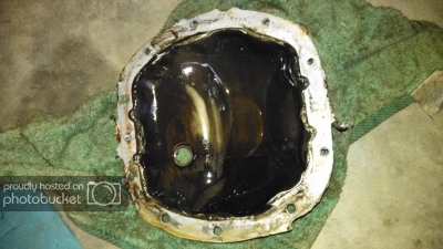

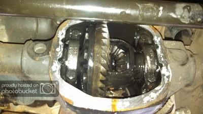

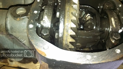

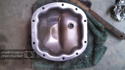

Got oil changed again in engine and finally decided to look what is in my differentials. So far opened only front, oil was relatively clean in it and didn't find any criminal damage or any damage at all, so that is good. Also I'm trying to figure out what all the different Dana means, my says "02 Dana D 48389.." is it good or bad differential? How hard is it to make a locker for it? Also on the body of differential there is number 0D 168 SW I didn't found this number in my book. Oh and one more question how many gear oil has to fit in differential, I was able to put in only 1.4 quarts and it started to overflow through filling hole?
This is how my diff cover looked like when I took it off.
I used just one peace of paper towel to get all the dirt out, so it looks like a lot but it wasn't too bad.
This is after cleaning.
