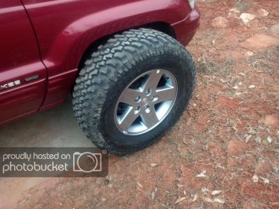

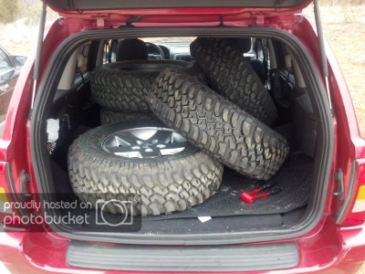

Hurray, I got wheels from Chase, BGF MK 255/75/R17, now just need to install lift kit and should be ready for Gulches. Will take some pics tomorrow.
#26

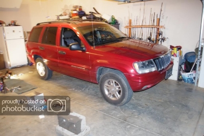

Finally have installed BB's and new wheels.

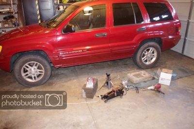

So here how it started:

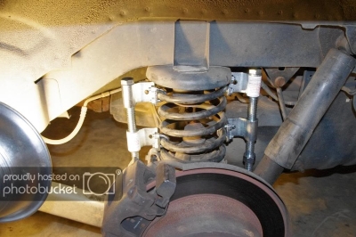

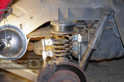

Don't think I would have finished it without this things:

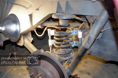

Now the springs are secure and ready to go out:

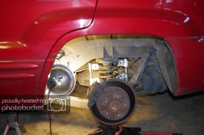

Installed BB and ready to lift the axel back on its place, hardest part was to get BB under the spring.
Yes!!! first wheel done:

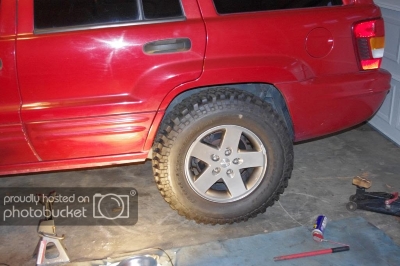

after 2 more hours second is also done, had to remove stabilizer suport to get the spring out correctly, on back wheels managed to install BB without any disassemblys.

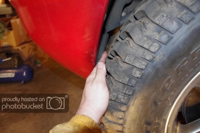

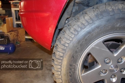

Not much space is left between wheel and front fender and inner-fender, will need to figure out the way to secure under fender and to cut as little of fender as possible to prevent rubbing
How it looks with one side done

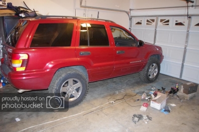

#27

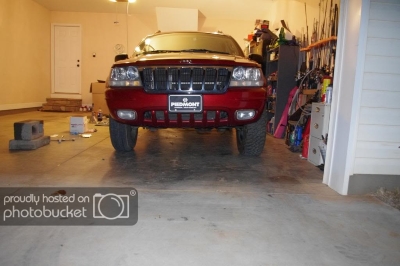

Setting up for the second side

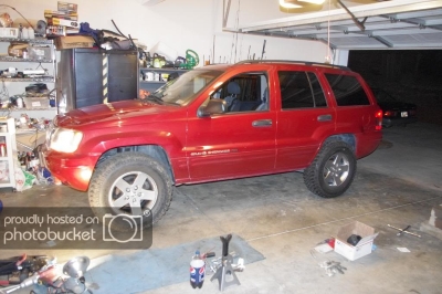

And finally I'm done

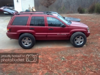

At the end clearence both front and rear is 16 inches total, spend 4 hours and 915$ to get it done.

#36
Guys need help with solving problem of wheel rubbing, my wife is totally against trimming, is there any other way to prevent rubbing (wheel spacers, overland springs????), I also wasn't expecting to have problem with rear wheels, but they also rub on bumps.:confused:
Sent from my ASUS Transformer Pad TF300T using Tapatalk 2
#37
First thing to do is to figure out what it is rubbing on first. Then it's easier to come up with a solution for the problem. In the front I think you are going to have to trim it to keep it from rubbing, looks like a tight fit.
#38
add bump stops before the tire hits
nevermin didnt loo at the pictures....if you take ur time and look around on the internet im sure you can trim them to look good maybe the wife wont even know
#39
Tell her tough shittin and trim. Your only running 2 inches of lift with bigger tires. Those tires could really use 3.5 inches and would still rub a little.
#40
Have heard something about bump stops but have no idea where to get one of the right size, or they are home made?
