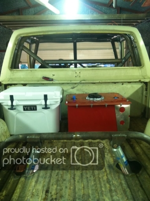

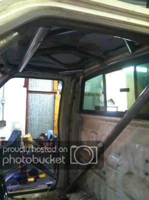

Overall except for a few notch/fitment issues I think the cage turned out alittle better than I expected. Once the seats and harnesses are in the cab is really gonna be tight. Which is what I was going for. Kinda like a cock pit type feel.

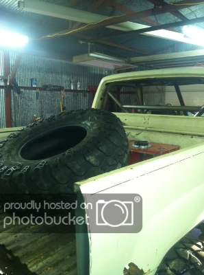

Made alittle progress this weekend. I'm down to baby steps in building lately. Hoping to make big gains this week on it. Really could use a good wheeling/camping/cooking/no work weekend.

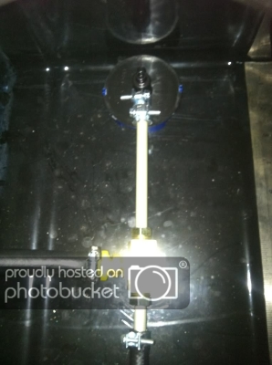

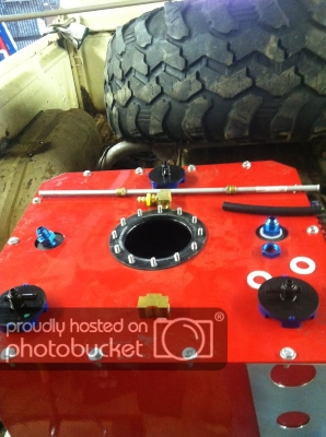

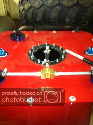

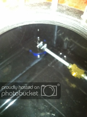

Been tinkering arod in the shop alittle lately. Decided to build my fuel cell today. Well install the Walbro pickups.
I used 2 Pickups in the rear of the tank and one front and center. I used 2, 3/8ths inverted flared t's and 3/8 brake lines already flared with a fitting on it. Submersible fuel line was used to connect the hardline to the Walbros.
