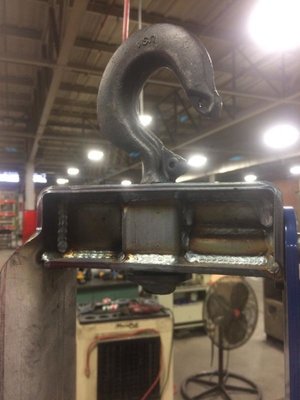

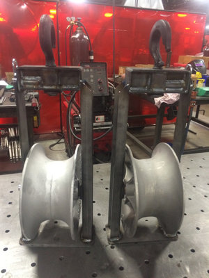

Pull tested another one of those breakaway sheaves today that's for a bigger sheave and a different design. Hook is rated at 4k and the sheave is as well.
29,383lbs and the metal tore. There was a 1.5"X1.5" .120 tube that's welded to 3/16" material.
Previous one I did straightened the hook out at about 28k but either way that's a far greater force then it will be exposed to.

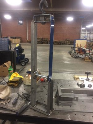

do you have a picture of that one before?
Nope. I can snap a pic of a proto one in the am. It's like the previous one except the base has a 1" flange on both sides to keep it rigid because it's designed to be used with an 18" and 24" sheave so much taller then the 12".
