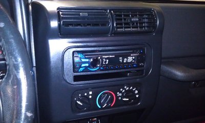

Installed a new radio today.
I'm really happy with the way it turned out. I think it's the most 'factory' looking install kit I've seen. The radio actually goes in from the back and screws to the dash piece. It doesn't use the face trim that comes with the radio or the metal sleeve that you usually mount a radio with. This radio also had the cd slot in the front instead of fold down face, so the face plate can be screwed to the radio.
It has bluetooth calling and audio streaming. The audio streaming is pretty cool for Pandora. The calling will probably be pretty much useless in a soft top Jeep, but it does display caller ID on the radio and tells you if you have a text message, so that should eliminate missed calls from not hearing it ring.

that mount is really clean, is that the $129 one?
#54
I went up to $159 to get the Sony with everything I wanted. Crutchfield gives you two options for free install kits and this is the second one, not the 'default' option. The stock speakers sound better with this radio then they did with the stock one, but I still think I'm going to replace both roll bar and dash speakers with 5.25 Sony's. Walmart has a good deal on them.

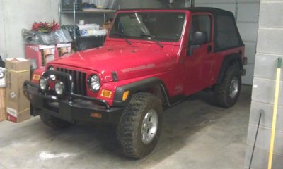

On our cruise last weekend, the left front caliper was sticking. I changed it out today and hope to get the front disconnects and steering skid on it tomorrow.
#58
I got the Kilby steering skid and JKS quicker disconnects on today. I thought I would have to modify the skid to fit with the ARB bumper, but it bolted right up. I need longer bump stops up front. The tires gets in to the fender a little...

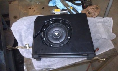

Finished up the stereo system tonight. I had big plans for the amp install to give myself fused circuits for future expansion, but that got abandoned for now. It's definitely not my best work, but it works for now. Only took one pic with the new sub in stock enclosure. Also finished up the install of the Bostons.
