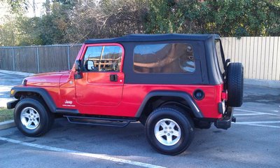

It's an '04 Unlimited with automatic. Looks to be stock and unmolested except for a Flowmaster muffler, a grill/brush gaurd on the stock bumper, and the 'rock rails' that just clamp on to the frame. It has a skid plate that I don't know if its stock or not.
There won't be any big build on this. It's going to replace the XJ, so there will be a for sale add soon. I plan to run the MT/R Kevlars off of the XJ but I haven't decided if I want to run them on the stock wheels or the wheels that are on the XJ. They are wider with less offset so will stick out a good bit. I may end up pulling the adjustable control arms off it too...

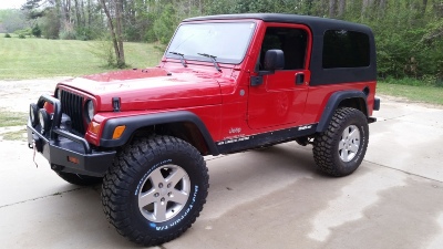

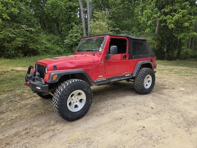

A lot has changed since I bought the LJ almost 2 years ago, and my comment of "There won't be any big build on this" has not been quite accurate. My plan shifted from leaving it mostly stock, to building something that LOOKED mostly stock but was a very capable trail rig, a Sleeper Jeep. It isn't intended to be a hard core crawler, but I wanted it to be extremely capable and comfortable to drive on long trips.
Current specs are below, with a list of things on the way. After these changes are done, I plan to be 'done' except for suspension seats unless I start breaking things.

I sold the Samurai 2/27, so the LJ has to become it's replacement. I stepped up to 35s, will be doing some axle reinforcement, and eventually some cage work.

On July 5th, 2019 I pulled the drivetrain to start a 5.3 swap. Wrapping up the details now and have put 180 miles on it. I did it as stock appearing as I could, to maintain the sleeper jeep.

Updating first post with some details. And thanks for the comments guys. Been in it all day and loving it so far. I got it in Clover, SC, drove to Columbia, then home and around town getting all the insurance and little things taken care of.

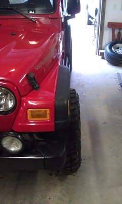

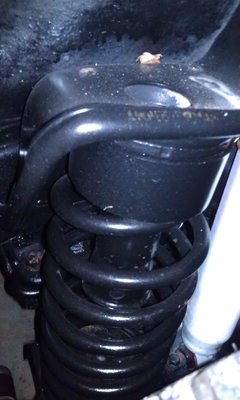

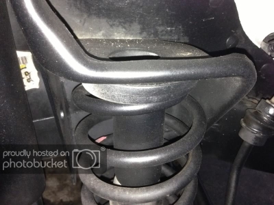

I put new pads and rotors on the front this morning and noticed that it has 2" rubber spacers on top of the springs, but I didn't think it looked lifted. Does anyone know if the unlimiteds had a spacer from the factory or is it a BB?
Also confirmed it has a limited slip rear. I think I remember reading that all the unlimiteds got the 3.73 LS Dana 44.

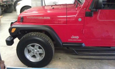

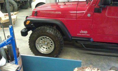

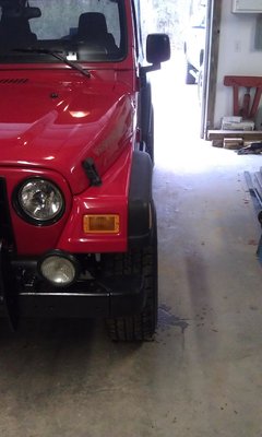

Need opinions on wheels. I'm going to run the MT/R's off the XJ, just don't know which wheels I want to use:
Stock:
Eagles 8" wide with 3.25" backspace I think:
#11
Here's what a 100% stock lj looks like.
Also I would keep the stock wheels.

it looks like it has aftermarket shocks on the front at least, but it doesnt look higher than stock. what size are the current tires that are on it?
#14
31". I'll take a pic of the spacers when I get back home.
Definitely a BB. I think I've still got a set of Rubicon springs around here somewhere. I may swap those.

It has spacers in the back to so I guess they had some rake from the factory. When I load it down with my tools, straps, spares, etc, it will sit level...
they have a good bit of rake from the factory, I guess the 31s are filling up some of the room that the spacer would have left. add a 1" body lift and mml and you will be good to go.
