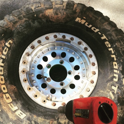

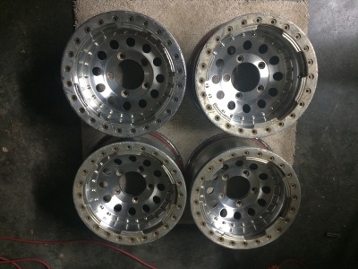

Sold my old km2s and picked up a fresh set from the guys at Clemson 4 Wheel Center. Now I'm doing my once every 8 year wheel polishing session.
24 bolts each
Forgot to take a before of the wheels but you can see the difference in the one ring I have finished.

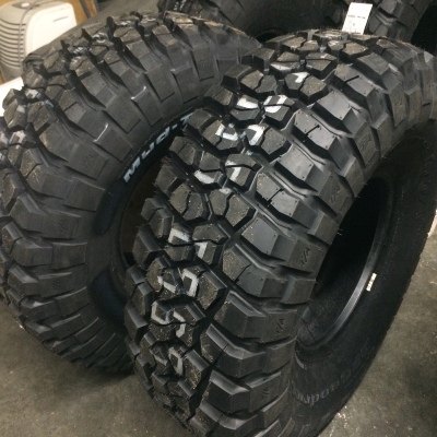

Been looking forward to these for a while
