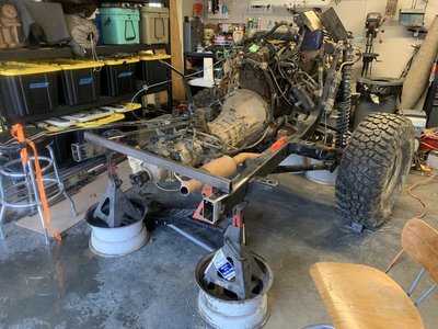

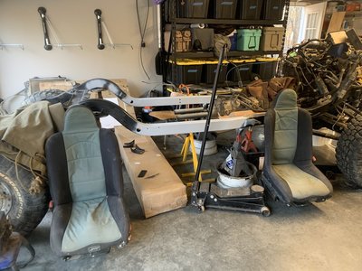

It actually came apart way easier than I thought. Its the putting it back together that will be more timely. I have a labeled baggy with every bolt and clip i removed. Sorted by part it came from and location on the jeep.
Ordered new clutch and flywheel today to try to fix the chatter I have had for the last few years.

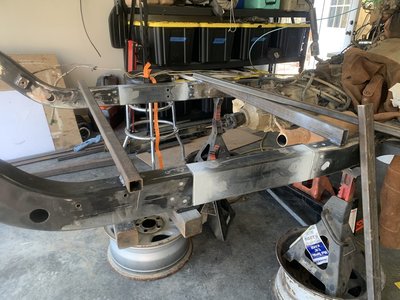

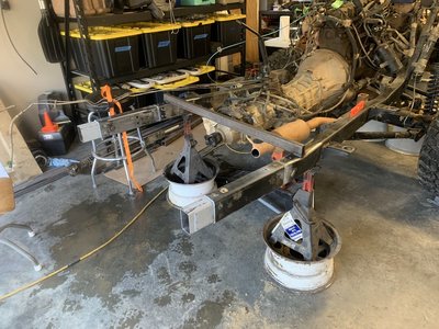

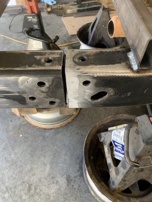

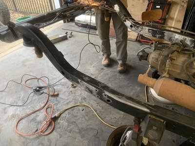

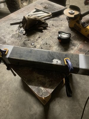

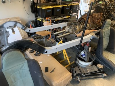

Well I was out of town this past week. Today I removed the control arm brackets and some of the other old frame brackets. Then measured, marked, cut, made the sleeves and almost put it back together when I ran out of welding gas. Gotta fill up tomorrow and hopefully get the frame back in one piece.
Lookin good Skerb. I assume you are plug welding the inserts for the frame extensions? Hard to tell on the phone. What thickness tube is that, just curious.

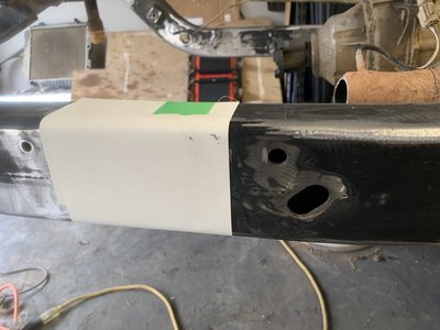

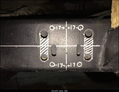

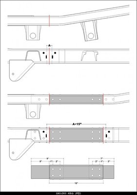

This is essentially how I measured for my cut. I didnt document it very well in photos, but I was basically using a number of center punch marks to check before and after.

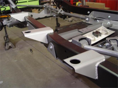

With your tub off, those would make sense. I didnt go that route because I wouldn't be able to weld the top well anyway, and they are for 1.25". My body lift pucks are 1".
Also, those gain you clearance, but aren't smooth like the SWAG ones.
I think mine is a 1" body lift, so that may be a problem. I do like that the swag look a good bit beefier.
