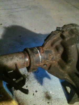

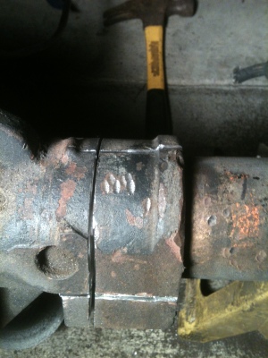

So Im trying to remove the cast leaf spring perch off the driver side of the axle housing. Me and David did some measurments today and its going to be in the way of my coil spring mounts. Anyone have any tips for this? Heres a picture of what I started doing and Im getting my *** kicked by it now, cant make it budge.
Cool good to hear. Getting dark and our lights in the garage suck. Ive just been worried about cutting to deep into the tube. Guess the tubes are thick and if I do cut a little deep can just weld it up after. Im gonna start cutting again in the morning.
I welded mine onto the cast. Yes people say stuff about welding to cast is weak, but it's almost as strong if you hear it up. So we heated it up before welding too it, and with 3/8 inch coil buckets I don't think it's going to be a problem strength wise
The welds made between cast and mild are not weak, there just a pain in the *** to do right.
There's a picture just a few posts up that shows a helleva lot easier way..........
yeah, he didn't cut the cast off......
oh, your talking about how mason welded it to the cast. mmmmm i'm still skeptical on that. I guess for a coil bucket it would be ok, I would hesitate to weld the control arm to the cast though. I know tons of people do it, I just dont like it. haha.
if ya scared, say ya scared. :flipoff2: lol..... cast steel and cast iron are way different. I know you can remember back in the day the pitman arms as highsteer arms.......
