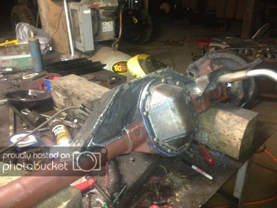

Axle is geared, and all put together. Here is a random pic after the regear.

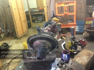

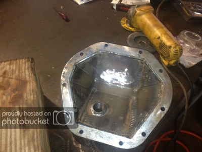

Then I put the diff cover on to find that it doesn't clear the ring gear bolts so I had to take out a little of material to get it to clear

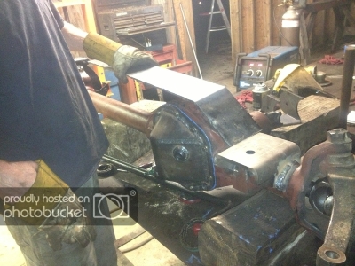

Then got started on the truss and burned the coil buckets in. Didn't realize they were 3/8 steel, complete over kill so I connected the truss to it.

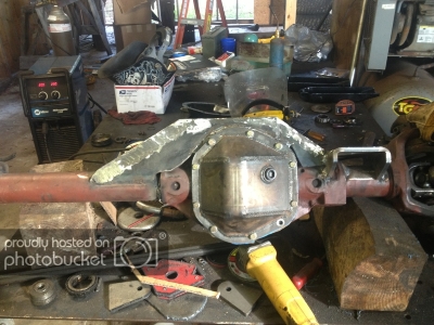

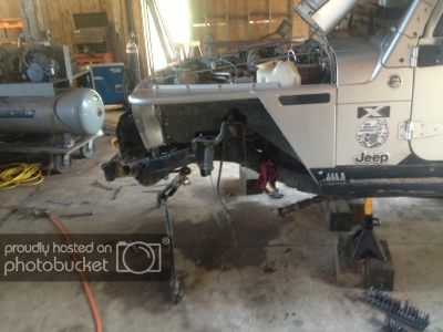

Got another pretty good chunk of work taken out today. Was workin alot slower today cause my uncle had a doctors appointment and didnt get back till 4. I finished up the truss cause I still had to fill in the back side, and another piece on the front and grind her smooth. Here is what the finished product looks like.
Then chopped the front end out. I've started hangin links and have the axle in position just forgot to take some pictures. Should be pretty darn close to finished tomorrow afternoon.

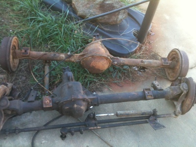

Finally went and got my 44. Got a set of J10 axles. Getting rid of the rear and then getting a 9" when I finish this. Thinking about going to a 3 link in the front over the radius arms Im running now.
