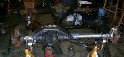

Ill pull a pic of what mine looks like. The guy I bought it from had run it in an xj with upper on passenger side so the way he mounted the brackets causing some frustration for me. The way brooks did it looks good though.
There's some other brackets ill have to find not on my phone that I'd look at too. They mount and push your axle forward a little.

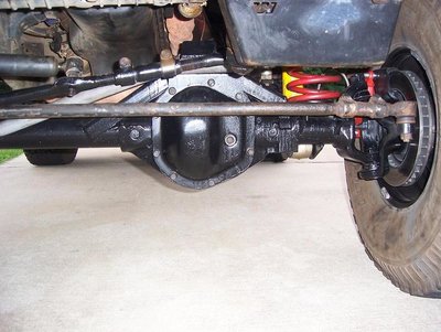

thanks for the pics guys. I was talking to marcus and he said he is still using the stock track bar location with his cross over steering. and he said he doesn't have any bump steer and the track bar is really close to in plane with the drag link. So i may try to do that. Cause that would save alot of hassle of where to put the track bar. And i can't imagine there is that big of a difference in the way mine will be set up and how marcus's sits right now.
#48
thanks for the pics guys. I was talking to marcus and he said he is still using the stock track bar location with his high steer. and he said he doesn't have any bump steer and the track bar is really close to in plane with the drag link. So i may try to do that. Cause that would save alot of hassle of where to put the track bar. And i can't imagine there is that big of a difference in the way mine will be set up and how marcus's sits right now.
i wouldnt do that. since he had high steer how many times do you think hes had that thing on the interstate and hit a bridge connection at 75?
and its really simple to setup with the trackbar mount to be correct, look at the last pic of my jeep. There is no reason not to do it right if your going to spend the time to do it.
i guess that's true too...
Never was on the interstate with the 44 in it. Hahaha now that I think about it only been on the interstate 3 or 4 times since I've owned it, other than on a trailer. I wouldnt say my trac bar is incorrect either.
