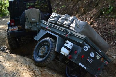

figured I would add some recent pics of the trailer. And I plan to do some upgrades this winter. One being new tires and a bit more clearance. I'm going to avoid the Spring Over and attempt to make some 2" drop hangers for the springs instead. We'll see how it goes...
I'll post some progress pictures when i get started.

did a quick spring over this afternoon to see what it looked like. Its not as tall as I was thinking it would be. I think it should work ok with the new tires. Hope to get them mounted this week before the toys 4 tots ride.
