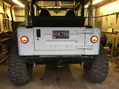

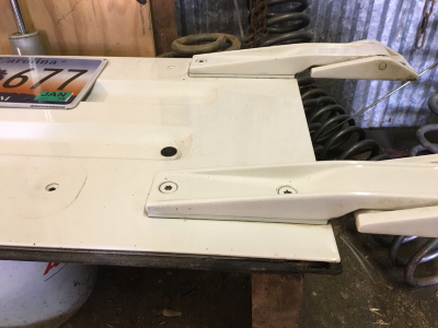

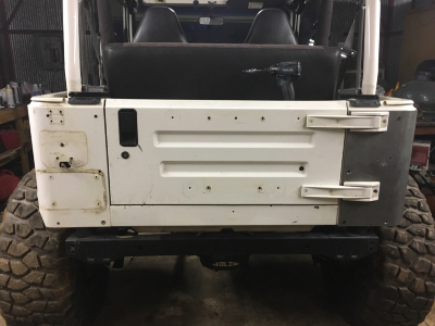

Got the holes drilled for the tailgate hinge. Wasn’t too bad. Still need to add the spacer plates to the tailgate itself but did get the corners and cowl sent off to Bud today so I’m ready to see how those turn out once installed.
Also, maxbilt made their order right and sent me a driver taillight and a return slip so I could ship the extra passenger side one back to them.

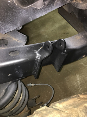

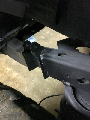

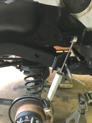

Waiting on my fenders to come back from paint so I got my rear shock mounts frenched in today. Wasn’t to bad but I’ve only got about 9-10” of travel. Way I set this up I got 5” downtravel and 4” up.

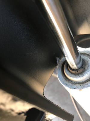

Did a little more tinkering today. Mounted the shocks and took a hot lap around the neighborhood. They are rubbing just a slight bit, I knew it would be close, but I think a lil flap disk will take care of it

Painted my mounting hardware for my rear corners since I haven’t found stainless hardware yet. Added the spacer for the tailgate hinge. Painted them white with some left over paint I had. And also mounted my license plate in my old Tire carrier location. Not sure what or if I’m going to do about a tag light, suggestions welcome. 79762177549aa056ec499155ccb69c4b.jpg

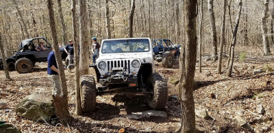

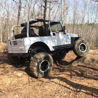

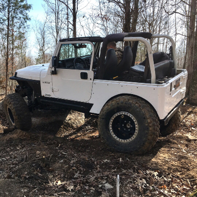

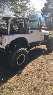

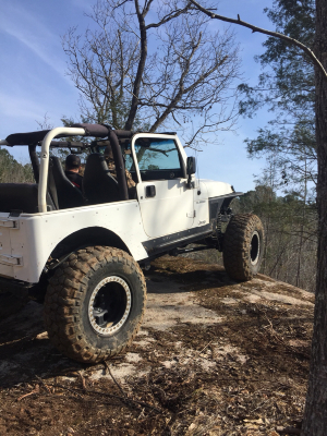

Well after just a little over a year I finally got the TJ back on the trails! I took it easy and honestly was a lil nervous something might go boom lol but it stayed in one piece and did pretty dang good! I might be wanting hydro assist sooner than later cause steering 37’s while locked on anything with traction sucked!

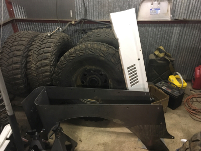

Got the rear corner armors back from bud. And love em they really tie it all together finally. Also installed my maxbilt Trail tail lights. Need to get the other 6lug wheels on my MTRs so I can drive it around town too this summer! Enough rambling. Time for pics
4dd9f484af272c7d5c38a12a946d3d23.jpg 18df24e06bd578abf81697c12f162d01.jpg pretty happy with the cuts I got on the rear fenders
20fead4e10ff5397e7e291608bb5de50.jpg 79a5f58f63b5842ccb32e4a135b8a230.jpg 325a5ddb944bddbb4f7c237a3773bb80.jpg

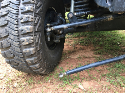

One Sunday was driving around town and out to the lake and lunch and got back in the yard and something felt loose. I looked out the window and my front driver tire was going left when I was turning right! The nut had fallen off the bottom of the tie rod. Thank god I was in the yard and not doing 60mph. Put a **** ton of loctite and a lock washer on it and it’s good now. 59806d71ae0b6652878e307f0707f513.jpg

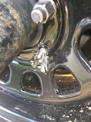

Had a wheel stud start free spinning on the front driver wheel and couldn’t get the lug nut off to take the wheel off so I finally chopped it off this weekend 8bc75ec01c5c438463947a4acd53287e.jpg
