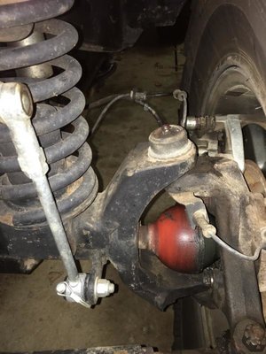

So got home a little to late to get good pictures but, I did do some measurements. The front axle is 2.5" O.D. and the rear is 3.25" O.D. those are approximate but real close. I did the measure outside circumference then divide by 3.14145 method. Based off the measurements I would agree with the dealership that the front isn't factory but, the rear may be. Both have a Solid brand D44 cover on them.

Those look like some nice axles to me. If you wheeled with a group, someone would have noticed if the ratio was different enough to pop it out of gear, especially on gravel or dirt. Do JK housings have the gussets on the inner C's like that? Are those not Solid 44's? I've never looked at a JK axle closely.

Mine is a Rubicon 44 with gussets. I don't think those pics show enough to determine more than a gusseted 44 with a Solid cover. Although there looks to be a little difference in the casting of your knuckle and mine.....
I guess yours isn't a Rubicon? Is that why there is even a question? Mine is not a Rubicon but has the axles out of a 2008 Rubi.

that is a 44 front, with some gussets, I didn't even notice at windrock. I saw sport and assumed it was stock haha.
