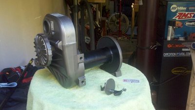

@VOLT what color was that you used to paint your winch? It's time to make that right too I think...

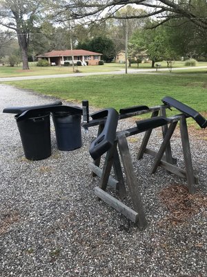

I went the bedliner route. The last coat is drying but they turned out pretty good. The flares had been painted before and they were going to be wayyyyy too much work to get down to the factory finish again. Plus I had a can of duplicolor on the shelf.
I used Martin Seynour from Napa cast something for the housing and cast aluminum on the drum. I literally threw the can out a couple days ago. That’s some great paint but I think it was really expensive.
