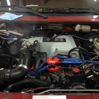

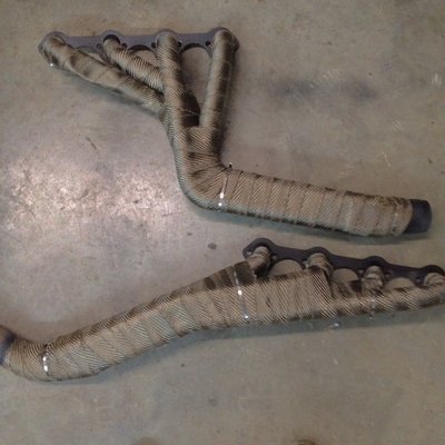

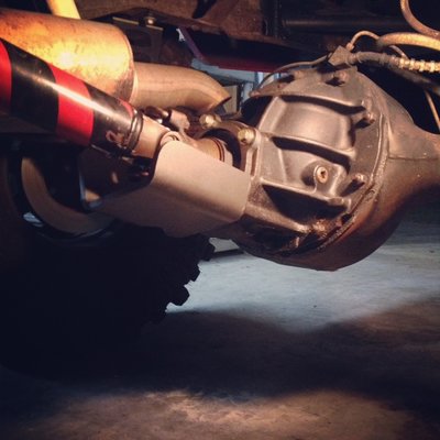

Did a little work to the truck this week. Added a pinion guard from Barnes and wrapped the headers. I ended up breaking a spark plug getting the driver side header off so I went ahead and put new spark plugs, wires, cap, and rotor on.

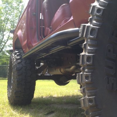

It's been awhile since I updated this. I've been making some changes so I'll bring it up to speed. Last year I was having problems with fuel delivery, since then I put a stock tank back in and that's fixed all those problems so far. I also added a set of trail-gear sliders, the 58" kit fit perfectly. They're welded to the frame and I ended up adding some polyurethane bushings to tie them into the body mounts as well.

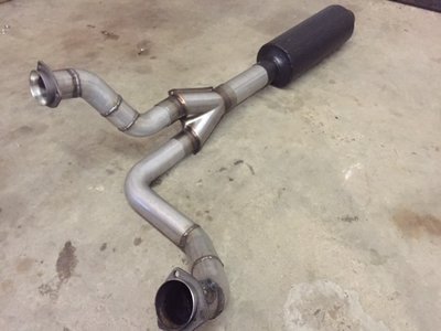

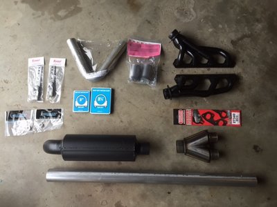

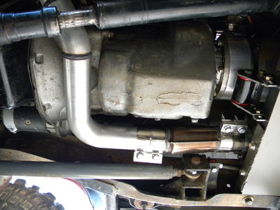

Last weekend I started redoing the exhaust, the headers hung below the frame and the muffler hung below the frame so I've been looking for a reason to redo that anyway. Anytime I've ever taken something to an exhaust shop I've never been happy with the results so this time I decided to do it myself. I got a flowmaster hushpower muffler, hedman shorty headers and some mandrel bends and y-pipe from summit and fit it all together. I still have to put it back on after welding and hang the muffler.

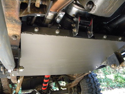

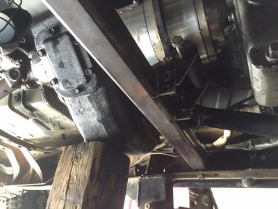

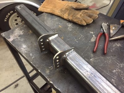

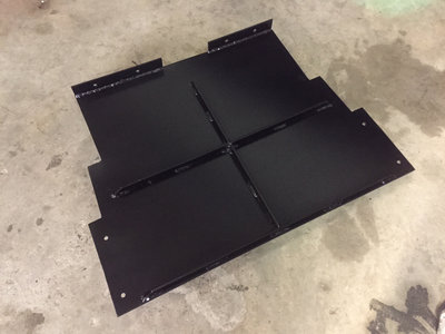

While I was doing the exhaust I figured I might as well raise the transfercase up above the frame rails so I can put a flat skid plate on it like all the cool kids. I made an adjustable transmission mount from some 2x2 square tubing. This raised my front driveshaft up quite a bit though so I'm hoping it doesn't come apart when the driver side droops down. I'm still working on the skidplate but it will be 3/16" steel plate I had.

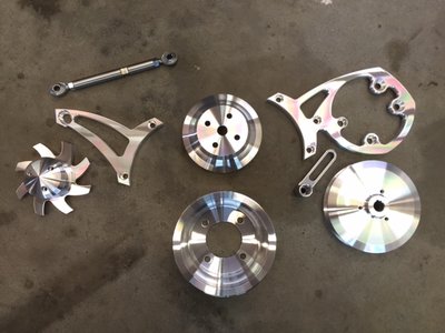

I also got a march performance serpentine belt bracket kit for christmas as my belt would eventually start squealing due to the pulley's not being exactly lined up.

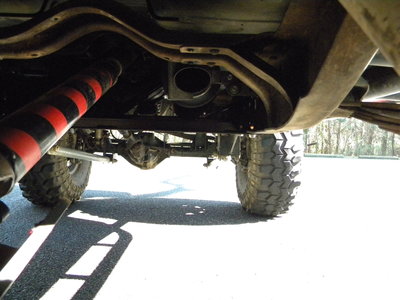

#35

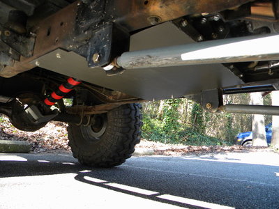

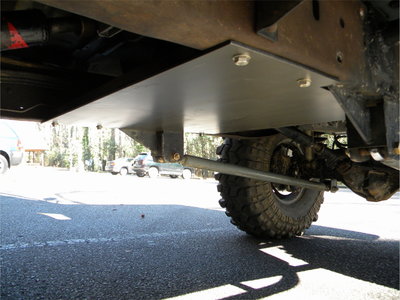

Got it finished up enough to drive last night. I'll have to end up doing something with the driveshafts but I think they'll hold up for atleast this weekend. The rear shaft has some awful vibrations when decelerating. But the skidplate and exhaust turned out pretty good.
#36
Very nice. Have you considered getting those lowers up more? Like a lot smaller tab higher up on the frame. And move the axle side around to the back of the tube. Just looks like they are waiting to get you hung up.
#37
Yeah definitely, that's the plan. I'm gonna chop off as much of the frame side lower link mount as I can and move the bolt hole higher up and redo the brackets on the axle. I haven't yet because the old transmission mount wrapped around the bottom of the frame on the passenger side. Now that's gone so changing the lower links is next
#38
I tell ya its hard to beat Barnes on brackets and tabs. Ive made my own tabs, tacked them together, drilled the holes, ground them apart and cleaned them up, then weld together a bunch of times. I get the whole free thing of building your own. But for one day shipping, laser cut and drilled. You get a lot nicer tab/bracket with no work. Plus the axle side you can choose multiple degrees of angle to suit your need. Frame side also. Ill never build my own again.
#40
Looks good..you going to extend the skid plate to cover oil pan?
Yeah the oil pan on here sits almost directly above the front axle center section since it's an early bronco axle, the center section is closer to center than most axles, but I'm gonna extend the skid plate to cover the front part of the exhaust and continue it up to the front crossmember in front of the oil pan.
