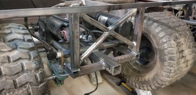

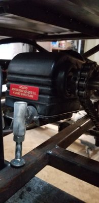

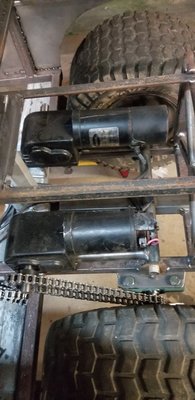

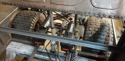

Cheap linear actuator is installed! It has built in limit switches. I also built up the motor mounts and added a trailer hitch receiver just because.
I mounted both motors in case I need the torque. Initial wheel spin tells me that my gearing might be off just a bit. The wheel speed might be a little too high for the kids right now.

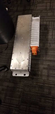

I want a couple of those in a golf cart !!!!!!
Me too. That one is just over 24V nominal. Around 300Ah with a peak discharge of over 300 amps, and continuous of 200 amps to maintain a happy life. I am trying to talk our team into letting me have the ones coming off of test. This one is just a single module, but they are testing one, two, and four module systems. After that they are scrap so I asked if I could have or buy them. They won't be full life, but should still have years of service in my projects since we build for a 6 year transit life working 7 days a week.

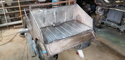

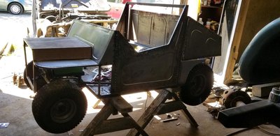

Well it didn't start any better. My grinder caught fire. After that the night picked up. I got the bed fabrication finished. Now it just needs final weld. Then i jumped over to welding work. There is a lot of seams on this thing so i will be tacking for days.
I did pony up and finally bought a new welding helmet after over 15 years. My Jackson is a solid helmet, but i picked up a Hobart Inventor the other day. It isn't my dream helmet, but it is amazing for all of this tacking work. Now to go buy a couple of new grinders.

this thing looks like a legit yard tool that kubota would sell hah.

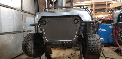

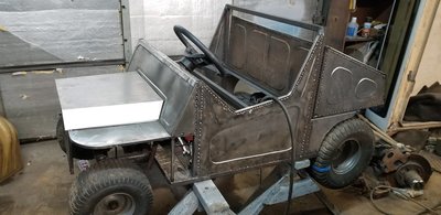

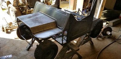

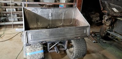

I decided to make a new hood. There were a couple of fitment issues I couldn't live with. then i welded up the front end and ground it all down! That sucks.
After that I machined a steering column and started to work it the full steering system. The motor tensioner system works, but i might have to rebuild the motor mount to quiet things down.

I like how the grill and hood turned out. What do you think this thing weighs?
Right now it is probably around 225. I could lift it if I could get a good grip. I don't have a lot more to add either. Another couple pounds of firewall, a little weld, and then some seats. Everything else is there. The main weight of course is the body, but the tires, motors, and batteries are no joke. If it works with one motor I will remove around 15-20lbs right there. It would be great to be able to use more plastic or fiberglass if I ever needed to build another one. I could also remove some weight by building more in a monocoque body style, but that would take more planning. The chair the motors came off of weighed around 75lbs and had a 300lb capacity. I hope it works out.
