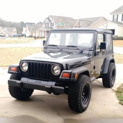

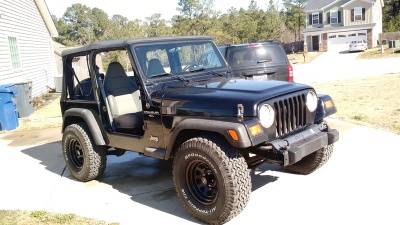

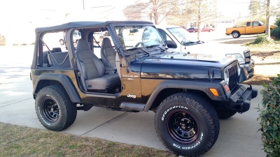

I traded in my JK to get a daily that is more baby friendly and I just picked up this Jeep around Christmas time. It's a 98 with a 4.0L and a 5-speed. It has a Dana 30 in the front and a 44 in the rear and overall pretty much stock. There's currently a random misfire I am trying to hunt down, but it is not throwing any codes. Overall it's in good shape. I am looking forward to playing with this one!

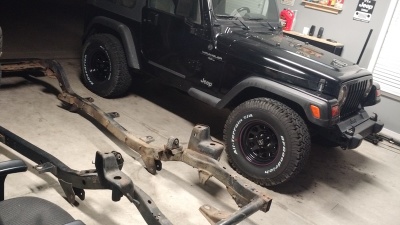

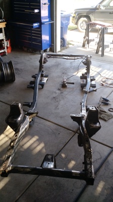

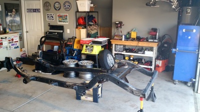

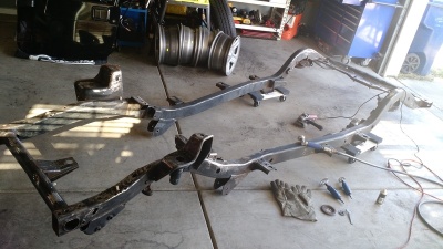

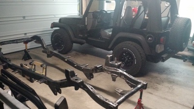

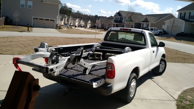

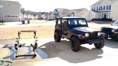

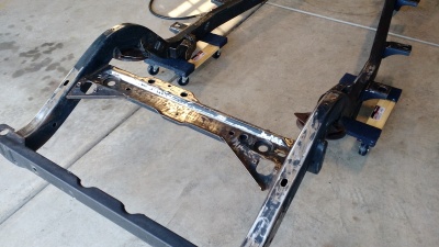

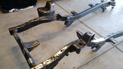

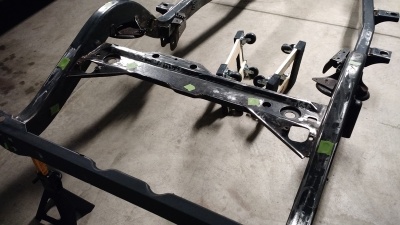

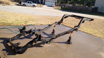

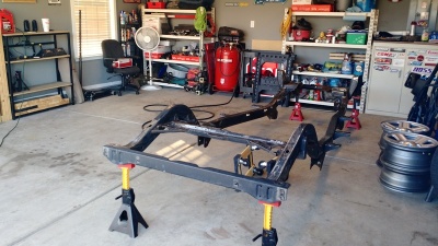

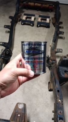

I am swapping frames now. I bought the Jeep knowing it had a few issues with the frame, but I got it for a pretty good deal. I decided against patching it. I figured by the time I bought the patches, I could get a new(er) frame. Of course this is more labor intensive than welding in some patches, but I think in the end I will feel better about it. I picked up a frame from a 99 4.0 last week and spent some time cleaning it up this weekend. I plan on painting it this week.
Also, Tripp and a few others have already told me I'm crazy/insane.
The night of picking up the frame

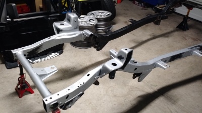

Cleaning the inside and outside
Side by side

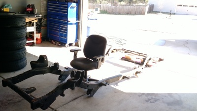

Testing the new seat

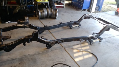

Cleaning up some of the surface rust on the frame

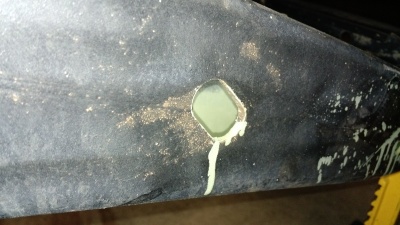

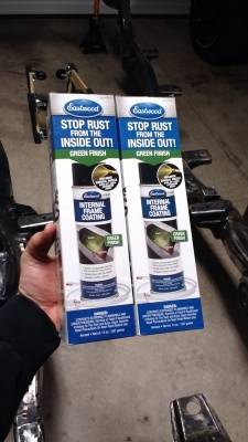

I'm interested in hearing how that inside frame coating works.
I've read some good things about it. I plan on taping up the holes in the frame so it doesn't spray out everywhere. I'm going to use a wire coat hanger in hopes to control the tube and nozzle inside of the frame. The inside is very clean, but I figure this can't hurt anything.

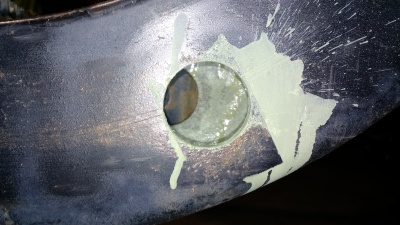

I coated the inside of the frame rails tonight...
Taping some of the holes so it doesn't spray out everywhere

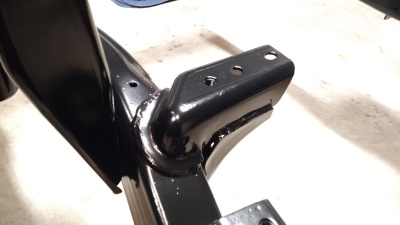

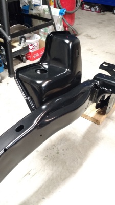

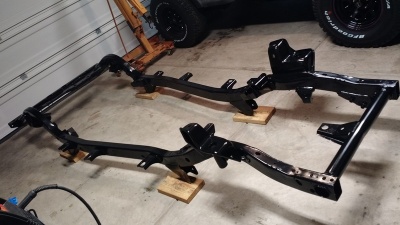

Frame went off to be sandblasted and powder coated. I should have it back Friday, which means the swap starts this weekend! There were some adhesion problems with the rust bullet, so I decided to go a different route. I think the temperature may have had something to do with it because I pressure washed the frame, ground and sanded it, then washed it again...
Also, thanks for fixing the thread, Tripp! I also just heard back from the guy and it's being powder coated now.
