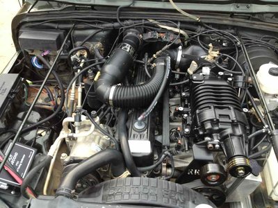

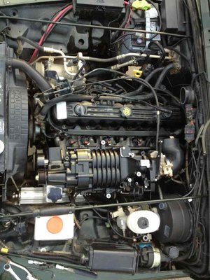

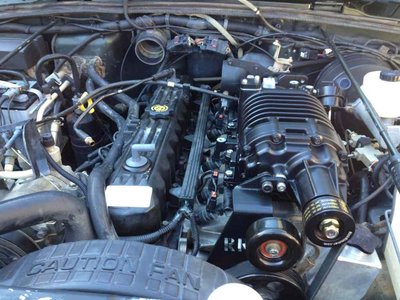

I got a couple hours today so after test fitting everything, I started with install.

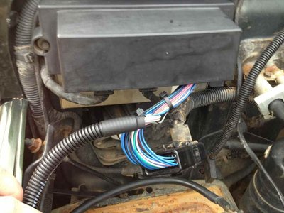

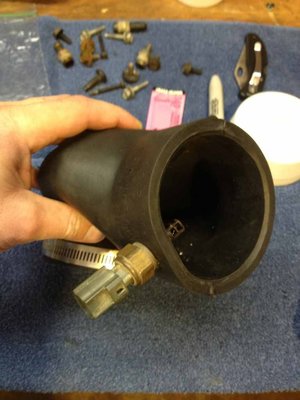

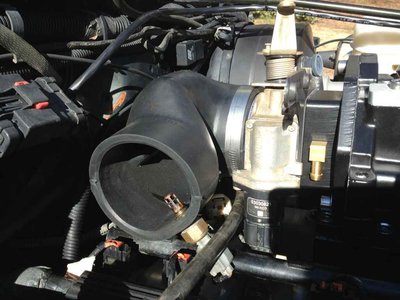

This is the air temp sensor that was mounted on manifold.  It now resides pre boost.  I just drilled the rubber cobra head air inlet.
What I didn't do was consider leaving sufficient room for the band clamp.  It will be fine but I could have left a little more room.

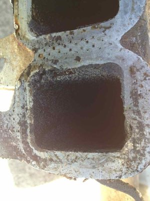

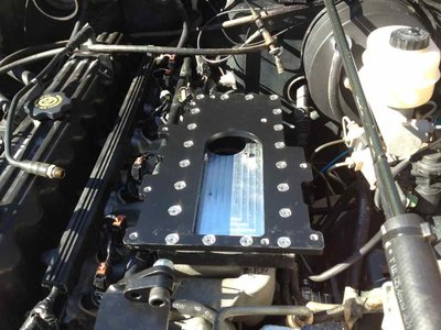

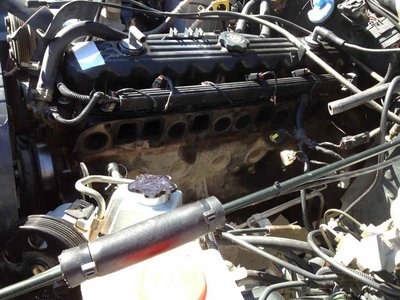

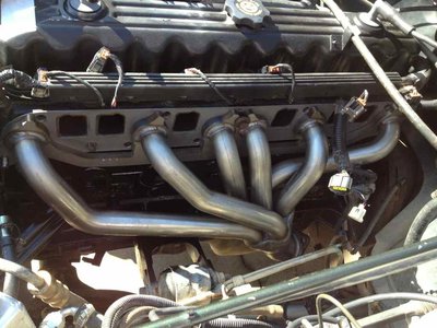

Here's a pic of the adapter spacer that allows the GM series blower to mount to the Jeep intake.

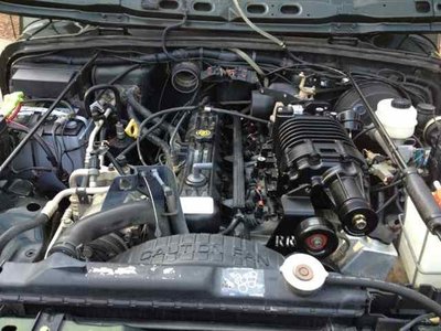

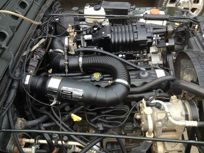

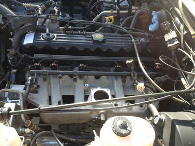

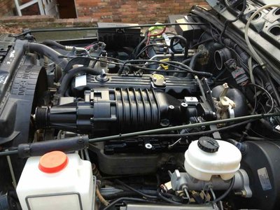

Here's the blower mounted with belt installed.
I had to stop there.  I need to swap a couple of those blower mounting bolts.  I just used what I could find for a couple of them.
