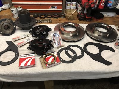

Very impressed with the Lugnut kit so far. Shipped same day, well packaged, instructions included, part #’s for pads included, banjo bolts/washers, hub seals. Everything looks to be lining up perfectly. I opted for the coated calipers, they look great. Going to need a new inner wheel bearing. I found a new outer and spindle in basement. Ordering a new fuel pump too, it shits the bed at wot now and then stalls. Also takes a few try’s to start.
