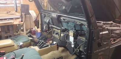

Well the wife approved the addition of AC to the Jeep.. $469 from Rockauto for everything but the drier mount $30 ebay and the re circulation door $45 from mymoparparts... Looks like DIY is gonna save me about 40% of the Jeep Air Kit. That also included a new heater core. I will just need to make a decal for my slide style controls to know where the AC works.
#35
I consider that a $500 win in my book
#36
I was able to order the decal and hardware kit from Jeepair, to complete my install $40... Should have everything i need to start pulling it apart this weekend. Probably start with my unit bearings, then move to the dash.
