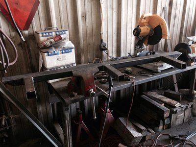

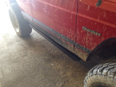

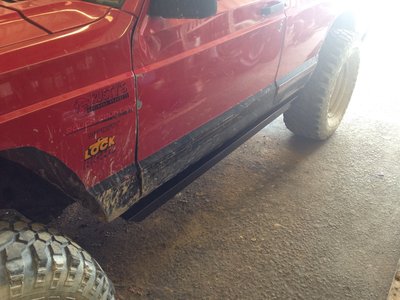

Brief update added 8.25 rear with open carrier,lockrite locker installed up front, took out the wood pecker and installed a newer 4.0 along with new hoses and such, new electric fan lol, and then new sliders added yesterday ImageUploadedByTapatalk1427041912.706731.jpg ImageUploadedByTapatalk1427041929.442997.jpg ImageUploadedByTapatalk1427041945.522297.jpg
