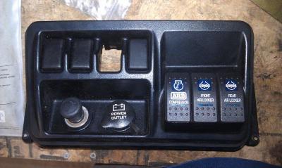

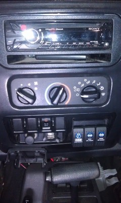

I got everything wired and the front locker plumbed Sunday and today. I was going to get the switches that fit in the factory knockouts, but decided to use the ARB switches to make things easier and to keep the blanks open in case I get hard top wiring in the future.
I put the switches in the flat space on the right side of the dash panel. The three switches barely fit, but it turned out pretty good.

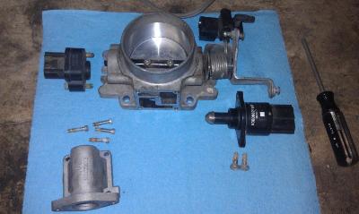

I've had some idle issues the past couple of weeks, and what sounded like a vacuum leak. I checked all the lines and couldn't find a leak, so decided to take a look at the idle air valve. I pulled the intake hose off and everything was pretty cruddy. So, this is how it sits tonight:
The idle air valve gasket fell apart when I took the housing off, and I can't find where I can buy one. Will check dealership tomorrow or RTV it.
Put it back together tonight and the idle may be better, but will have to drive it more to really know. It still whistles, and I couldn't find any leaking vacuum lines. Now I'm thinking intake manifold gasket?
What's the best thing to use to spray around the intake to check for leaks? Starting fluid?
And just FYI, the idle air valve housing gasket isn't available anywhere, even dealer, so I used rtv gasket maker.
Does the IAC not have a O ring for the seal?
It does, but the IAC housing to throttle body had a paper gasket that fell apart (the part in the lower left of picture that goes onto the surface of the throttle body that's facing the camera). That housing wouldn't have to be taken off to clean it, but I did...
Ah yea, I just figured it was really sealed by the O-Ring when I replaced mine. But mines also developed a skip again, and cleaning the IAC didn't fix it...so who knows. It's better but not gone completely.
