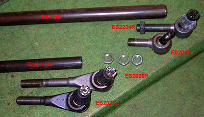

did you warp the threads in the bung when you welded it in?
I think somebody on here mentioned they had a chaser for Chevy TRE threads.
Nah, some thread in perfect and some dont... Just seems to be the ones from Advance that don't.
#55
I didn't use the 1" in fear of breaking the joint, 3/4 would be just fine. I used it because the bearing is much larger and should last a LOT longer than a 3/4" before it gets slop and starts squeaking
