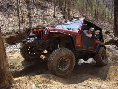

Well everything is ready for the final photos and test drive but.....Apparently when you move the axle farther back you close the distance between the shock mounting locations, silly right......Yeah forgot to take that into account when I ordered my 5100's sooooo the rears were too long, only had about 2-3" of up travel. So I ordered some slightly shorter ones and they should be here Friday. Final wheel base is just under a 100", 98.5..not bad considering the stock TJ is 93"
Well the new rear shocks arrived, still a little too long (collapsed length). Looks like outboarding the rear shocks is in the future. However that aside, the frame swaybar mounts required relocation farther to the rear. I fabbed up some new mounts and burned them in. I still need a static drive way shot but, until I get it cleaned up for the driveway photo here is the shake down run flex shot. The suspension performed very well, even with the shock length issue.

So...the rear stretch helped the front flex? That can't be the best picture you got...
Flex isn't that big of a deal for me so what I'd like to know is...did you notice an improvement in stability and/or climbing ability?
#31
Your right about flex, it flexed really well before but, I think the overall ride and stability was greatly improved. It is a much smoother ride on and off road. The rear end moves much more freely without the track bar. Climbing is much improved, the ledges at TNT rock garden and Radical ravine were cake, I was really surpprised how easy it went up both of those.

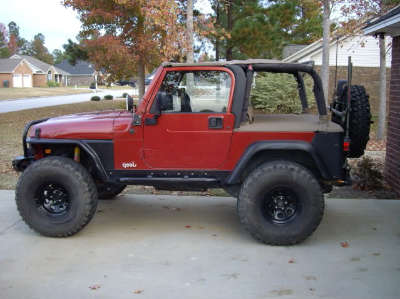

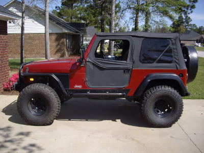

Here is the before and after I promised.
Before: IMGP1238.jpg
After: IMGP2634.jpg
