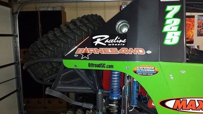

Thanks guys for the support. The one thing I changed this year on the car wound up killing my chances of finishing the race. Last year the exhaust dumped down right after the driver compartment, this made for a droning in the cab at certain RPM's and interfered with the intercom system between Driver and Co-Driver. This year i ran the exhaust all the way to the back of the car which lead to the exhaust being close the the fuel cell and fuel pumps. I heat wrapped all componets cause I knew heat might be a issue. I didnt protect the fuel cell or fuel pumps enough and overheated the fuel system.
