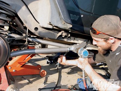

The RC kit uses the same bolt for the rear uppers and lowers at the frame. So there is literally no vertical separation at the frame. It also uses Radius arms on the front, which many people love, but in the end, its a design that fights itself constantly and wears our bushings like hell.
