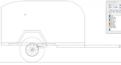

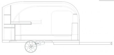

The first version of our offroad Teardrop treated us very well for 2 years, but lately I had been daydreaming of ways that I would do it differently if given the chance. Rather than retrofit the existing camper I found it would be easier to start fresh. Sooooo... I started drawing version 2.
There were a few things that I knew could be better. I wanted to address a few shortfalls of the first design:
MaxFan instead of Fantastic Fan.
Larger Door opening with the bottom even with the floor
larger storage area with bigger door for accessing rear cargo
front storage area inside in the front.
6" more headroom (for kids bunk)
This will allow us to store everything in the back of the teardrop or in the front box and not need to store things in the camper.

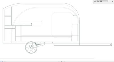

Here is a comparison of the old vs new.

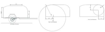

And here are the dimensions I have settled on.

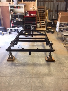

#9
Is that a 4x8 or a 5x8?
Did the same people make it that did your last one?
How much did that one run?
This one is 5x9 and it was made by the same company @CrossCountryTeardrops
I added a couple k to what I sold my last one for. I opted to use some of the nicer parts this time for the build.

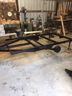

#10
So I had always kept a torch in the camper for lighting fires and other pyro needs. It had been rolling around in a container. This time I found a water bottle holder for bikes that fit the torch perfectly. I mounted it standing up in the rear storage area.
https://www.amazon.com/gp/product/B01JUKV71Q/ref=oh_aui_detailpage_o02_s00?ie=UTF8&psc=1
This is the torch, althought its about half this price at lowes where I bought it.
https://www.amazon.com/MAP-TORCH-BE...TF8&qid=1537879390&sr=8-11&keywords=map+torch

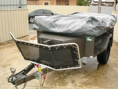

I'm looking at doing some sort of stone guard on the camper possibly. They are very common in Australia, but not so much over here. I'm thinking something similar to this, but not sure. Its that or some god awful mud flaps on the tow vehicle.
