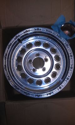

Thanks but I went ahead and picked up a set of alloy wheels yesterday. Just looking for tires now.

I really don't want anything less aggressive than BFG AT KOs, but who knows. I won't need wheels. I got a set of five Eagle Alloy 101 series.

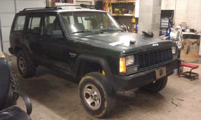

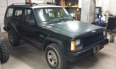

This morning:

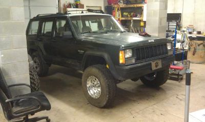

Now:
Progress did not go well, but it's on its own weight with all the adjustable control arms in and I think they're close to right. There's no steering (RockAuto sent me one wrong TRE and I don't have jam nuts). There's no trackbar because I don't think I have the right hardware for either end...

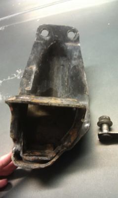

I found my death wobble cause... The frame side trackbar mount had one broken bolt and the other one in from the bottom was loose. The flange of the motor mount that the front bolt goes through is also broke. I've got to move the truck enough to either weld a bolt to the broken bolt or just weld the bracket on.
Is this a stock trackbar bracket?
The welds look like crap so I wasn't sure if it was factory...

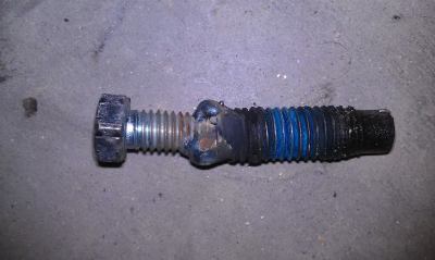

I got the broken trackbar bracket out, can't believe this actually worked:

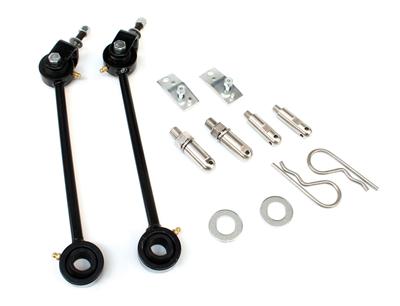

Question - what to do with the rear sway bar? Leave it connected like stock? Remove it all together? Longer links?

many people take them off and use the brackets as bar pin eliminators on the rear shocks.
