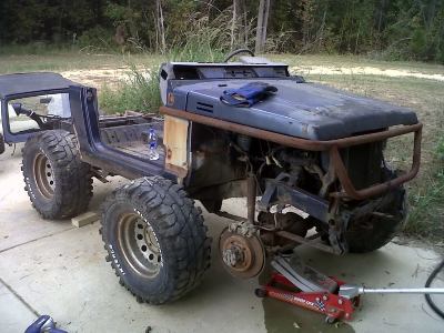

Two weeks before a trip to Uwharrie with Clemson Offroad club last fall, a friend of mine (Tripp) asked if we could put together one of my parts Samis so he'd have something to wheel.

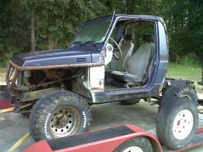

I bought this '87 last year, purely for parts. It had been chopped off, had a motor that was supposed to be good, and the clutch, flywheel, transmission and many other parts were in boxes.
We started by removing any 'good' body parts that were left to keep for spares, and stripped anything else that wasn't needed.
We bolted the drivetrain back together and it RAN :eek:! So we took it for a ride!
http://www.youtube.com/watch?v=C-RiVAfFCr4
#2

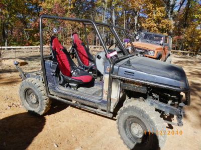

Everything at this point was either parts I had laying around or hand-me-downs from my Samurai. I bought new suspension seats and put the plastic buckets in this one. I got a free set of old military skinnies from my cousin and plasma cut the wheels out to fit the hubs. We checked out a few other things and sent it off to have a cage installed.

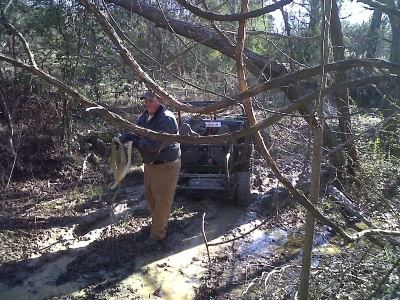

When we picked it up from the fabricator (Tuesday night before leaving on Friday) it wouldn't stay running. We messed with it for a while, started to rebuild the stock carb. Then Thursday night we decided to ditch the stock carb and installed the Weber off of Dylan's old motor. It ran like a champ, but a little smokey . So we loaded it up and left for Uwharrie.

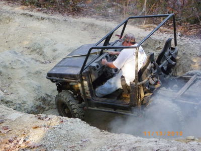

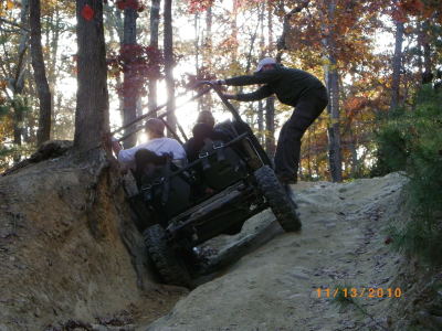

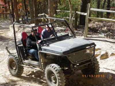

We had a fun trip and it worked much better than anybody expected. Tripp did get stuck on a tree... and I had to drag it up Daniel Ledge...
#3
With my Samurai, and my Dad's, Tripp decided to call this one Frank, and the name stuck.

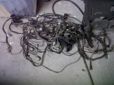

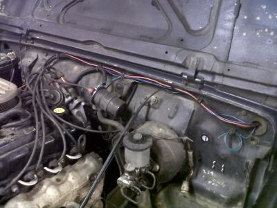

Since then, we've added rear shocks, replaced the rear springs with good factory ones, started on a rear tube bed, made a top, installed gauges, and done a little wiring simplification .

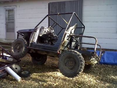

its been a bit since the sidekick axle was pulled, but Frank did get 4wd again this past weekend. She rides much better being 10 inches longer and on air shocks:grinpimp:

Is it just the picture, or are the link mounts outboard of the frame rail? If so, why not move them to the frame for at least some lower link triagulation? Maybe it's just the angle of the pic. I can't tell.

Lower links are mounted to the stock Rear-front spring mounts. Under the frame.

The pic is deceiving, the lowers are mounted in the old leaf spring hangers on the frame, it was done that way because it was easy, fast, and cheap...
we did it with parallel lowers and triangulated uppers.
