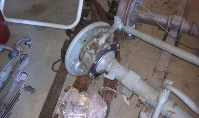

got the outer knuckles cleaned out and cleaned up the king pin bearings since we are reusing them. The axle is ready for the new parts and brakes.

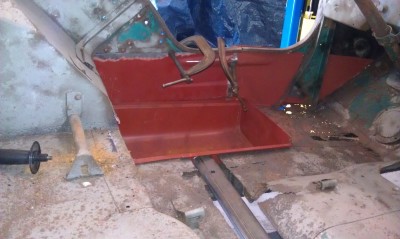

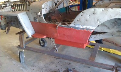

I guess some of the progress pictures have been posted in the MCJ section, but here's where we are now. We actually started fitting new panels today!
We also took the knuckles back off to install the seals and felts that somebody forgot... :shaking:
