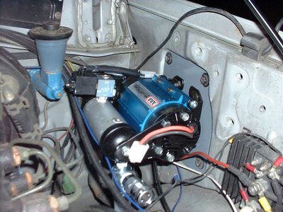

The switches arent the problem, its the white plug on the compressor that has a bad connection.
The plug on compressor looks like this:
I'm going to replace it with a high quality deans connector:

Oh I see what you mean about the Tamiya plugs.
I just installed my pump this weekend. I'll keep the info handy in case I run into trail troubles. So if it happens again you could just cut the plug of and twist wires.
#23
when I would wiggle the plug it would cut the compressor on, so yeah, I suppose you could twist the wires together in a pinch. I plan to spend the $3 and just put a nice plug on it.
