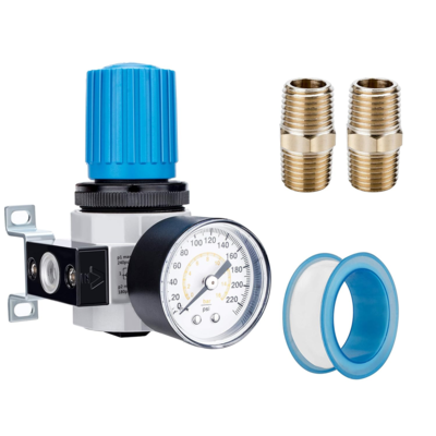

I'm thinking I could use an adjustable pressure regulator with 1 inlet and a Y on the outlet and just set the regulator to the pressure I want the tires to be. That way when its to pressure, the pressure will build in the input line from the compressor to the regulator and the compressor will shutoff.

It should work. I have the same type of regulator on my shop compressor. I crank it down to 40ish when winterizing the camper, but I don't really know how accurate it is.
You'd need good clip on or screw on open flow chucks on your output lines.

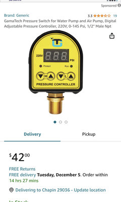

More research required but what about an air pressure switch? Don’t know that it would work either. Ideally having max compressor psi output until desired psi is researched would be ideal….the regulator is going to take forever once it gets close to set psi I think. Not bad if you walk away and aren’t sweating fill time but the compressor is going to get hot. I know my dual Arb is super warm when I’m done filling mine
https://www.amazon.com/dp/B09JL7BL6...crb_top?ie=UTF8#cm_cr_carousel_images_section

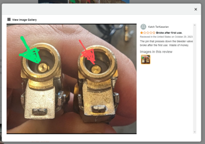

I have these Haltec air chucks in my cart from when I was researching a while back..
https://www.amazon.com/Haltec-H-5265-Standard-Lock-Chuck/dp/B01938M8MW/ref=mp_s_a_1_2?crid=Y14JFY45DID7&keywords=haltec+air+chuck&qid=1701268862&sprefix=haltec+,aps,121&sr=8-2#aw-udpv3-customer-reviews_feature_div

I like those chucks, might be a good compromise for the locknflate.
I have locknflate in my cart but can't justify $50 for a chuck, not to mention 4 of them.

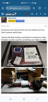

Maybe a wireless airbag compressor setup would work. Airlift and even some off brand Amazon compressors have apps or remotes to pump to a set pressure and automatically cut off.
#14
I dont remember if I still have this, gave it away, or threw it away. I'm sure the compressor wouldn't have the capacity to do anything, but I wonder how the controller worked...
