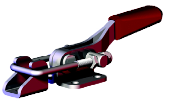

I need to make a few modifications to the trailer before she is ready to go...I love the ammo can latches, but I am having a hell of a time getting one to latch. I am not sure what the issue is, but it worked prior to the lift support installation. I am thinking of backing the side of the tub with a bit of steel to stiffen her up...if that does not work, I was looking at these....do you think they will work?
http://destacoclampstore.com/index.php?option=com_rokecwid&view=ecwid&Itemid=16#ecwid:category=688851&mode=product&product=4465629

I used destaco latches on my new lid. I had to brace the tub rail where the hinges are with 1x2x1/8" box steel so that even those latches would work properly. The trailer bowed to much without it, that is the issue you are having as welll.

Hmmm....Ok...I think I will just try to brace the inside of the tub with some 1x1 I have in the garage....
