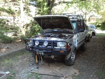

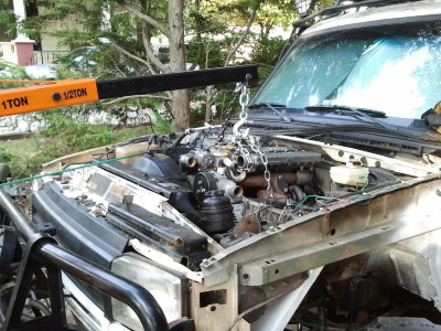

More progress today! I finally got the engine sitting on its mounts in the truck. I ended up having to cut the mounts off of where I had first welded them on, they ended up being located too high on the frame. I then bolted the transmission into place and installed the radiator, fan, and fan shroud. I positioned the engine such that the fan was centered in the fan shroud, or it would be when the engine was sitting on the mounts. At this point the engine was a little higher than I wanted it to sit in order to compensate for the compression of the engine mounts. This compression amount I had to guess on the first try. The mounts ended up compressing more than I had anticipated and on the first try the fan blades were almost touching the bottom of the fan shroud. I cut the mounts off again and figured out how much more I needed to lift the engine to compensate for the compression of the engine mounts. The second try was a success, with the fan sitting centered in the shroud. I ran out of daylight today so the mounts are just tacked in at the moment. Tomorrow after church I will burn in the rest of welds and then this big step will be DONE!! I will get some more pictures of the install tomorrow, but this is how it sits at the moment:

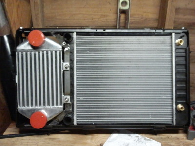

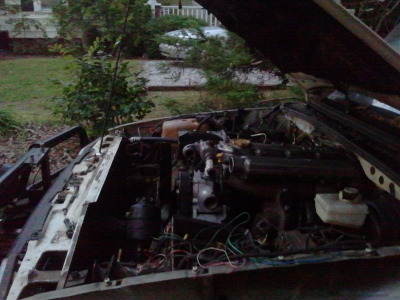

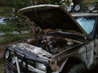

Got a little more work done today on the truck. The hood is back on, so its starting to look like a vehicle again. I also test fitted the radiator and intercooler in their frame to make sure they will fit. Everything looks good; even though the intercooler isn't the stock intercooler it looks like everything will fit with some minor trimming. I cleaned up the radiator/intercooler frame from rust tonight as well and tomorrow I will repaint them before assembling the radiator/intercooler assembly and dropping it in. Oh, and I also got the wheels back on the truck. Sorry the pic are a bit blury, it was getting pretty dark by the time I remembered I hadn't taken any yet.

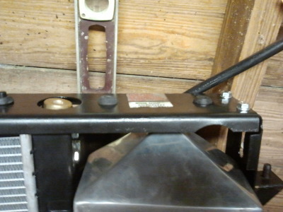

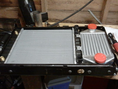

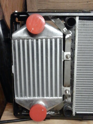

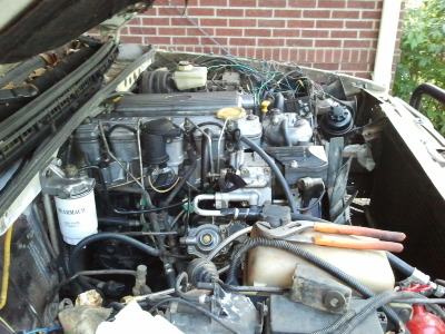

Got a little bit more work done today on the truck. Got the radiator/intercooler frame painted, got the fuel filter installed on the firewall and most of the fuel connections mocked up. I am missing a couple fittings that I'll have to get before I can have it fully connected. I need the banjo bolt that attaches the fuel line to the injection pump and I need a compression fitting to attach the fuel supply line from the tank to the inlet of the fuel pump. Then I got the radiator and intercooler mounted in the frame and it looked good, however, when I went to install, the intercooler was running into the A/C condenser. There's not much clearance between the condenser and the radiator in the truck. This intercooler, which isn't stock, is a little bit thicker than the standard intercooler and this is causing a problem. I'll have to make a couple more modifications before it will fit properly. I also started the plumbing on the pre-oiling system but have to wait until everything else is done so I can find a location for the pressure tank for that system. Some of the pics below are unrelated to today's work but I wanted to include them because when I was researching this swap, there were no pictures of anything. Most of this I've been able to figure out as I've gone along but it would have been nice to have pictures to reference in order to plan in my head how everything was going to go.

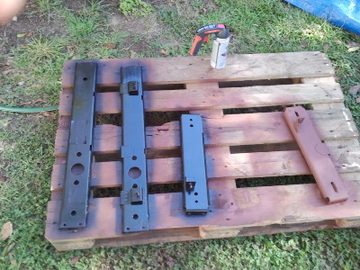

Radiator/intercooler frame getting painted:

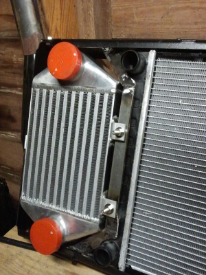

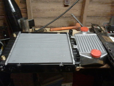

Radiator/intercooler installed in frame:

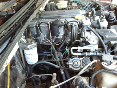

Passenger side of engine showing Fuel filter and routing(incomplete)
More of the same:

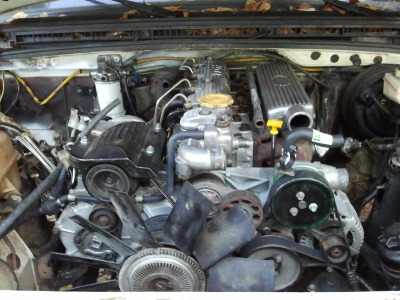

Front of engine, no radiator yet:

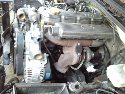

Driver side of engine:

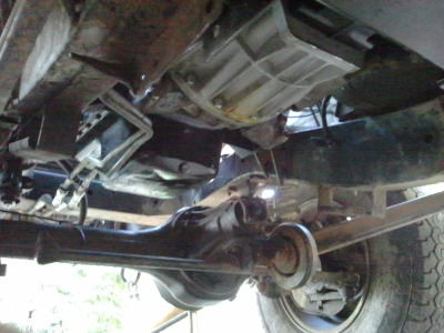

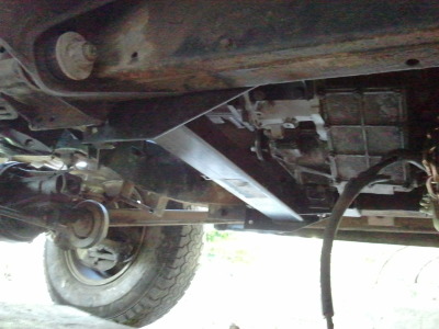

TDI transmission crossmember w/ transmission mounts:
Another underbody shot:

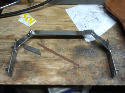

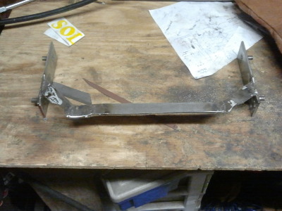

Alright some more progress: Got a frame built to hold the intercooler in place and the radiator/intercooler is installed in the truck. The radiator plumbing is mostly installed, driveshafts are back in, and all work under the truck is finished apart from filling the transmission and transfer case with oil. The transmission cooler hard lines did not fit correctly and interfered with the TDI so I will be replacing them with SS braided teflon lines eventually. The transmission was shipped with a trans cooler blanking plate because in England the trucks did not come with a transmission cooler, so there's not a rush on getting those lines finished. The exhaust will also need to be done under the truck. The intercooler plumbing is proving to be a challenge as all I got from the guy who sent me the engine was a hand full of elbows and a section of aluminum pipe . . . so I'm still figuring that out. That in addition to the inlet/outlet to the intercooler is right in the middle of the radiator plumbing. The new banjo bolt for the fuel inlet on the injection pump has arrived and I'll get that in this week(end) and I'm going to focus on the intercooler plumbing as well. Here's some pics of the progress with the intercooler frame:
