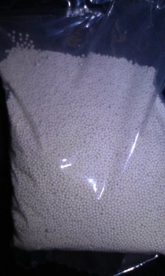

I didn't think about taking pictures for a review until after I started, but here's what was included:

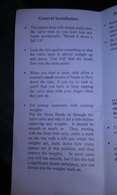

Instructions for the pour in valve stem method:

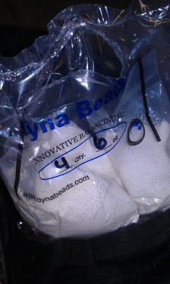

Packaging:

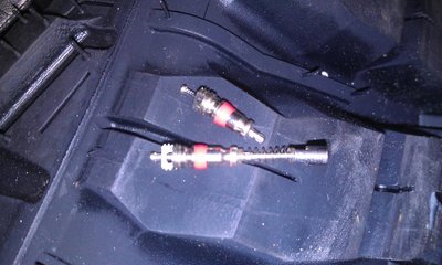

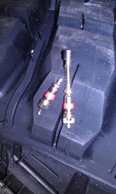

Normal valve core on left, filtered core on right:

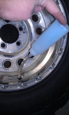

Installation:
If I use them again, which I probably will, I will have them put in before the tires are mounted. The through the valve stem method takes forever and is a pain. You just have to take it slow.
My initial impression is good. I had a slight shake the first time I got up to speed around 45, but I didn't feel it again. I'll try to remember to post back after a couple weeks to let you all know how its working.
