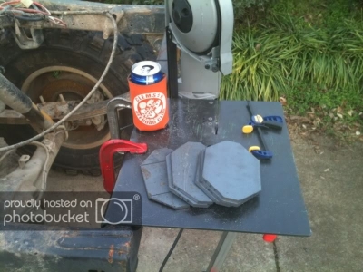

#14
I just built a mount for my HF saw this weekend. For the money this saw has been great and still working fine after probably 5 years now. I find the vertical setup to be the most useful so that's what I wanted. My buddy has a Dewalt in the Swag stand and it works great.
I put this together with about 1' of angle iron, and about 2' of 2" flat stock I pulled out of a scrap pile. Cost was $0 and a few hours of figuring out how to make what I wanted out of what I had.
I've seen a few other vertical mounts made with square tube bases and hung from the handle bolts like that horizontal mount above (google image search). I didn't have material for that and worked out this option. Mounts with 2 of the bottom cover bolts and through the handle. Looks sort of hack, and it sort of is being I was working with scraps, but it works and its solid.
#15
Got some more pics of the mount I made The table and the base are separate. The saw bolts in at 3 points using original bolt holes, though I did drill the hole in the handle out to 1/4". The table bolts to the original guide mounts.
table
The ugly welds were done w/ a stick welder after we ran out of gas in my buddy's mig. I had 1/2 of it already done so he just finished it off with the buzz box.
#16
table
nice work on that mount!
