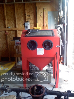

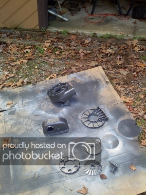

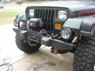

that one looks soo sharp... on a yj imagine what it would look like on a tj :hnd: haha here's some pics from yesterday, forgot to take a picture of all the pieces after they were sand blasted though.

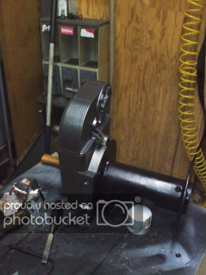

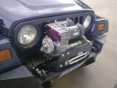

almost done with it. still waiting on some parts from warn to finish up the breaks. also still waiting on my synthetic line to come in. but this is how it looks right now!
#29
actually the seals on the drum were in good shape, no dry rot, or anything. and it fits good, not any play at all. on the case i didn't bother buying one, i just used some silicone to seal it off.

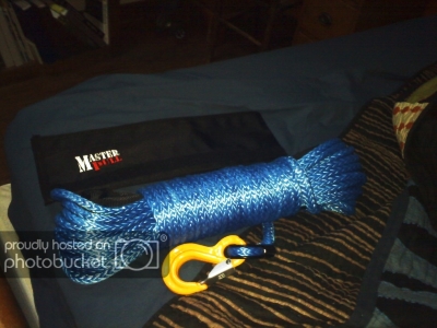

some goodies :grinpimp:

what length rope is that?
yeah i ordered it directly from warn.com, cause it was really easy to use the manual to find the part number, then put the part in the cart.
and its 100ft of 3/8th.. didn't really see a need for 125 ft in the south east, trees are everywhere, and i can always just hook up a 25 ft strap to get to the tree.

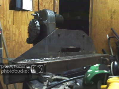

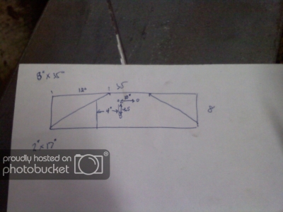

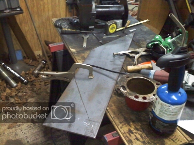

started building my winch plate today, until my grinder broke... then i had to get a new grinder, but man is this dewault 10 times better than the northern tool special! what took the old grinder 10 minutes to cut i was able to do in like 2 minutes. both sides have been cut, but i just took a picture of where the northern tool special died. also here is a picture of all of the measurements for warns winch plate (thanks brooks)
the 2x17 is for the braces on the back of the winch plate. will take pictures of that later.
