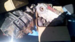

well more changes to the fj. After finding out the sm465 dana 300 combo wouldnt work I had to go a different route. The 32 spline sm465 had a crazy long 10.5 inch adapter making the combo over a foot longer than the factory setup. In such a short vehicle this was no bueno. So after cutting my losses on that setup I found a guy in birmingham (or he found me rather) with a 10 spline sm465, advance adapters cruiser case adapter, a cruiser case stiffener, and a factory cruiser case with the lower low range (2.4 to 1). I traded my dana 300 and some cash towards this stuff. Now im still going to get about the same low range as the other setup, a shorter powertrain, and my cruiser wont be getting jeep-aids. I also wont have as much drive shaft headache and wont have to build a centered rear diff axle. This works well because with the size of the cruiser diffs (9.5 inches) it drags enough as it is and being offset helps greatly.
Heres a pic of all my crap piled in the back of the jetta. 40 mpg makes going to get stuff far away much more attainable. Filling it up and driving to birmingham and not seeing the gas light again till greenville city limits was nice. May even get a couple days of commuting from that tank.
